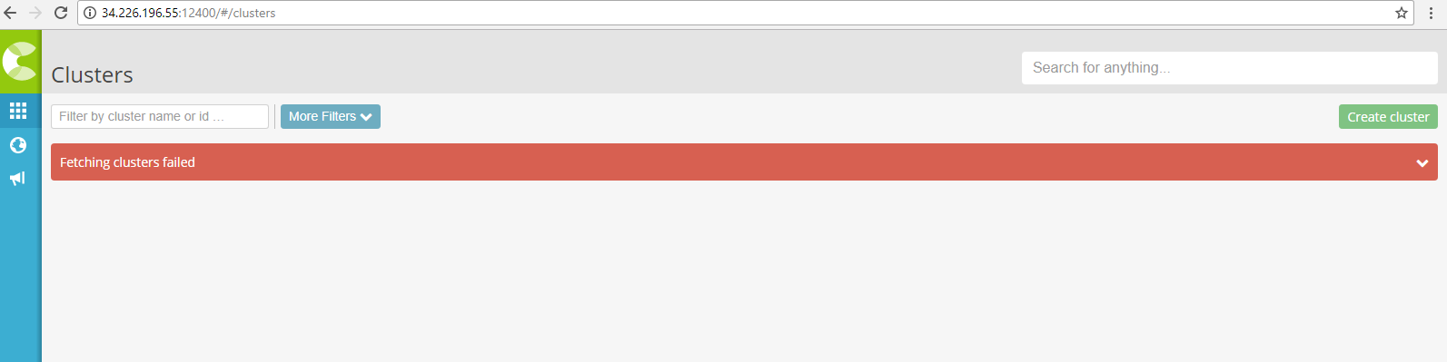

**Author:** ![annu](https://avatars.discourse-cdn.com/v4/letter/a/5f8ce5/32.png) [@annu](https://discuss.elastic.co/u/annu)\
**Post date:** [October 12, 2017, 5:47am UTC](https://discuss.elastic.co/t/500-an-internal-server-error/103543/5 "2017-10-12T05:47:01Z")
</div>
Hi
I was using 32GB disk and 1GB memory for my cluster(i created). Due to the increased memory pressure, i changed the memory from 1GB to 2GB. While that migration was happening, my UI went down and now I'm getting "Fetching clusters failed" and "service unavailable" errors when i login to my ELK.
And i'm getting "{"ok":false,"message":"The requested cluster is currently split"}" when i try to hit my elastic search endpoint.
thanks
Annu
**Post date:** [October 12, 2017, 6:46am UTC](https://discuss.elastic.co/t/500-an-internal-server-error/103543/6 "2017-10-12T06:46:58Z")
</div>
![elasticsearch](https://us1.discourse-cdn.com/elastic/original/3X/6/8/68f7af7c10ca5bdd794a76e5c24f956effb4d331.png) ![cluster](https://us1.discourse-cdn.com/elastic/original/3X/c/9/c9d8b5b59da505f6c83cffa7ca6de1bafcaa70c9.png)

**Author:** ![Alex\_Piggott](https://sea2.discourse-cdn.com/elastic/user_avatar/discuss.elastic.co/alex_piggott/32/11053_2.png) [@Alex\_Piggott](https://discuss.elastic.co/u/Alex_Piggott)\
**Post date:** [October 12, 2017, 1:24pm UTC](https://discuss.elastic.co/t/500-an-internal-server-error/103543/7 "2017-10-12T13:24:26Z")
</div>
Thanks for the details, seems like 2 things have happened:
- When updating an overloaded cluster you got a split brain situation - this has started happening with a bit of regularity, and once we get the platform back I will provide some strategies for dealing with it
- The split brain has somehow taken down the administrative cluster that the UI uses to display the clusters ... this I haven't seen before
Can you run a few API commands as the user `readonly` (which ensures you don't leak any secrets)
- `curl -u readonly:PASSWORD "http://HOST:12400/api/v1/clusters/elasticsearch"` - returns a list of all the clusters and their health
- `curl -u readonly:PASSWORD "http://HOST:12400/api/v1/clusters/elasticsearch/XXX"` where XXX is the adminconsole cluster return from the previous call
- `curl -u readonly:PASSWORD "http://HOST:12400/api/v1/clusters/elasticsearch/YYY/plan/activity"` where YYY is the cluster that you upgraded and split brained
- `curl -u readonly:PASSWORD "http://HOST:12400/api/v1/platform/infrastructure/allocators"` - provides information about the health of the allocators that run the clusters
(API reference: [https://www.elastic.co/guide/en/cloud-enterprise/current/ece-api-reference.html](https://www.elastic.co/guide/en/cloud-enterprise/current/ece-api-reference.html))
