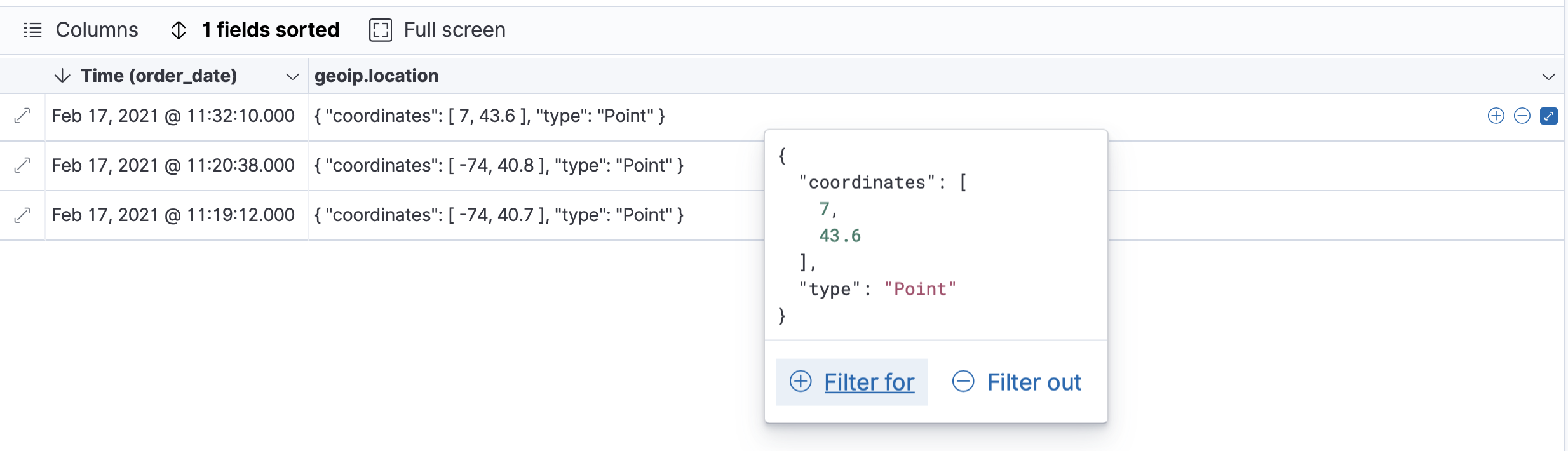

Hi!
Did an upgrade of the ELK-stack from 7.10 to 7.15 and in that jump the format of coordinates in Kibana changed
Previously it was just like any other field in the discovery view
> location : 11.111 , 22.222
now its
> location:{ "coordinates": [11.111, 22.222], "type": "Point" }
Anyone have an idea what happened and how can it be fixed? It looks ok when requesting the document directly via API but Kibana and csv-exports are messed up.

Hi!
Thank you for the response. Im not sure i understand the question.
My problem is that in version 7.10, a row in the discover-view would look like this
Field1: data1 Field2: data2 Field3: data3 Location: 11.111,22.222 Field4: data4
In version 7.15 its
Field1: data1 Field2: data2 Field3: data3 Location: { "coordinates": [11.111, 22.222], "type": "Point" } Field4: data4
Since i made the post in this forum i have found a post at Github which describes the same issue, but im not sure what the status of that issue is. Implemented and solved in february?
> <https://github.com/elastic/kibana/issues/91637>
> We used a custom formatting function when we integrated \`EuiDataGrid\` in Discove…r. And decided to later on remove it, since it should be taken care of Kibana field formatters. So here is how we rendered it before removing this functionality:
> !\[Bildschirmfoto 2021-02-16 um 10 16 44\](https://user-images.githubusercontent.com/463851/108210409-cce4a100-712b-11eb-864b-a8a881121fc5.png)
> When we removed it, it looked like this:
> \<img width="1234" alt="Bildschirmfoto 2021-02-17 um 11 32 57" src="https://user-images.githubusercontent.com/463851/108210497-e71e7f00-712b-11eb-87e1-492dcc842991.png"\>
> Clearly there's potential to format the value in a user friendly way
7.10
 ![image](https://us1.discourse-cdn.com/elastic/original/3X/f/5/f58bca8762fcb90c30c2002eb0644e5398baac24.png)
7.15
 ![image](https://us1.discourse-cdn.com/elastic/original/3X/7/a/7a35019e803bd4426f48022fa6239c11f2a91511.png)

### Author: ![Nathan\_Reese](https://sea2.discourse-cdn.com/elastic/user_avatar/discuss.elastic.co/nathan_reese/32/84829_2.png) [@Nathan\_Reese](https://discuss.elastic.co/u/Nathan_Reese)
#### Post date: [November 15, 2021, 3:55pm UTC](https://discuss.elastic.co/t/changed-layout-of-coordinates-geopoint-after-upgrade-7-10-to-7-15/287365/5 "2021-11-15T15:55:56Z")
</div>
The old format can be used by using the setting in the _Advanced settings_ in Kibana, Stack management using setting: `discover:searchFieldsFromSource` . It defaults to `false` and you can set back to `true` causing the representation to be like it was prior to `7.12` .
`discover:searchFieldsFromSource` is removed in 8.0 so this solution will only work through 7.16
I have also opened [this issue](https://github.com/elastic/kibana/issues/118559) to create a field formatter for geo\_point fields to allow users like your self to customize the display of geo\_point fields without having to set `discover:searchFieldsFromSource`

Thank you! That was it!
Got it regarding 8.0 and hoping for a permanent solution.
