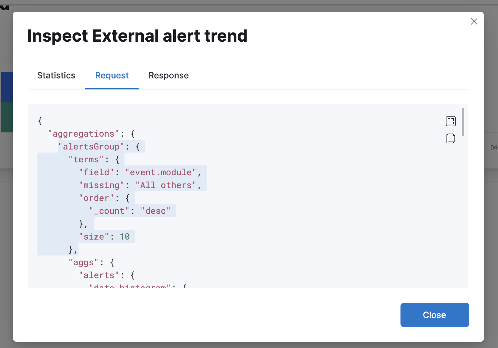

> \*\*Describe the bug:\*\*
> In our security solutions application we use this type of… query in a lot of places and mark the UI as being "others" when in reality this is not "others". It is actually the missing records and values:
> \<img width="812" alt="Screen Shot 2021-04-26 at 11 00 06 AM" src="https://user-images.githubusercontent.com/1151048/116122124-9b81d780-a67e-11eb-896a-91d78c73ab9d.png"\>
> \`\`\`ts
> "alertsGroup": {
> "terms": {
> "field": "event.module",
> "missing": "All others",
> "order": {
> "\_count": "desc"
> "size": 10

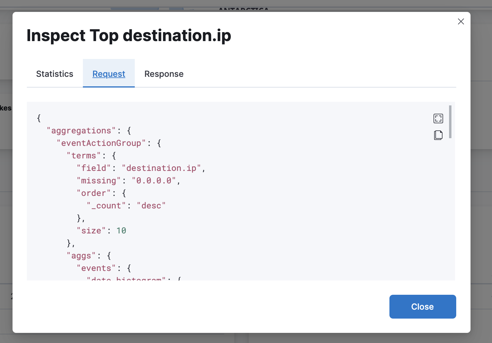

> Top N record queries:
> \<img width="825" alt="Screen Shot 2021-04-26 at 11 02 03 AM" src="https://user-images.githubusercontent.com/1151048/116122511-1cd96a00-a67f-11eb-9194-160b3f91f9f5.png"\>
> \`\`\`ts
> "terms": {
> "field": "destination.ip",
> "missing": "0.0.0.0",
> "order": {
> "\_count": "desc"
> "size": 10
> We also using missing inside of alerting and a few other areas. However, we are not consistent with misusing missing records as an "others". Not all our widgets use this paradigm. Some widgets use it, some do not use it.

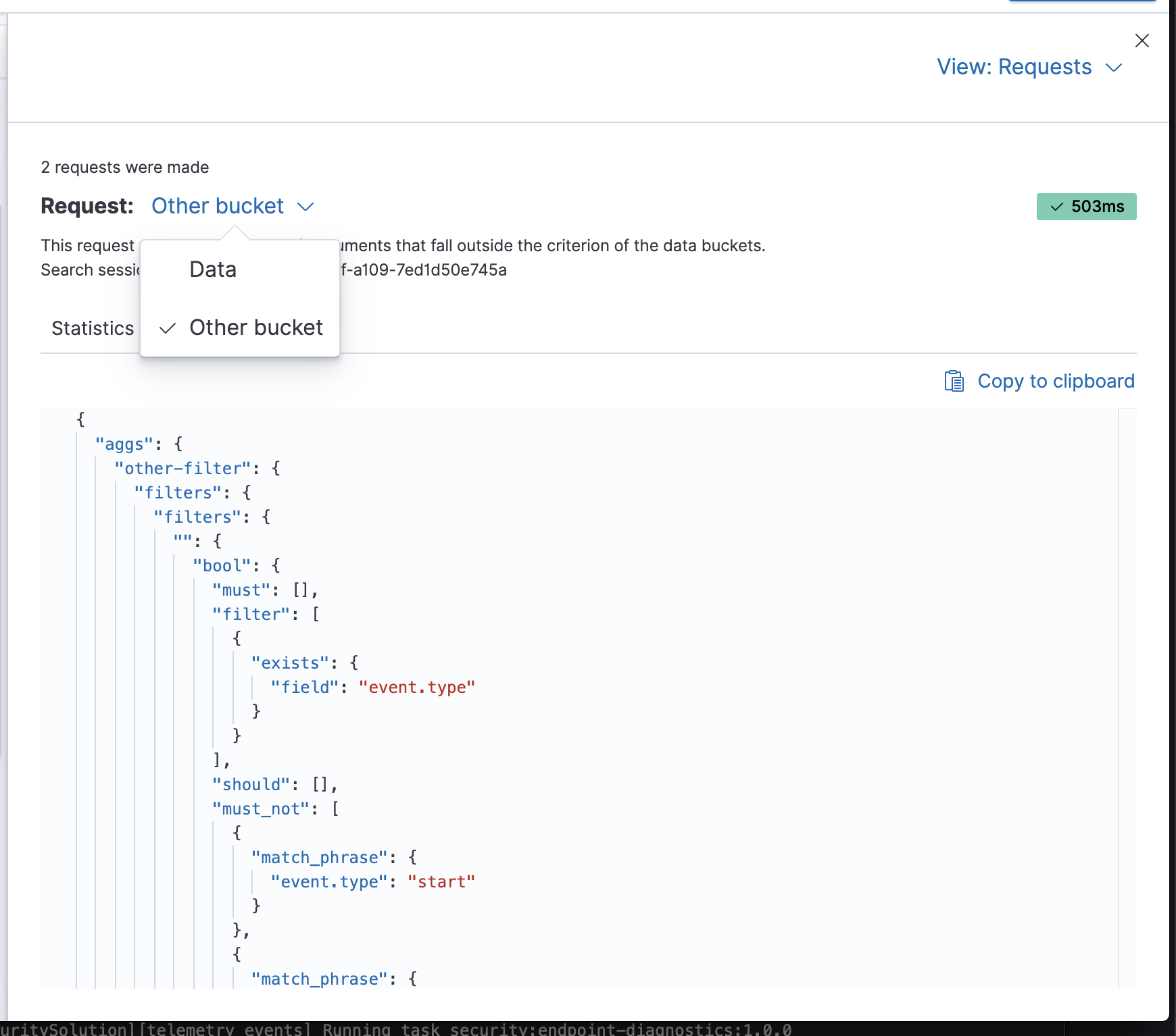

> Another bigger issue is that this UI/UX is telling everyone that this is "others" when in reality is showing "missing" records. To do true others, we have to use two queries like Lens has. See this:
> https://github.com/elastic/elasticsearch/issues/12411#issuecomment-508502044
> Screen shot of lens doing two queries to get true others:
> \<img width="870" alt="Screen Shot 2021-04-13 at 3 44 50 PM" src="https://user-images.githubusercontent.com/1151048/116123016-b43ebd00-a67f-11eb-80a6-e2272298c0cb.png"\>
> We should change our queries to utilize a true "others" and remove the "missing" based queries.
