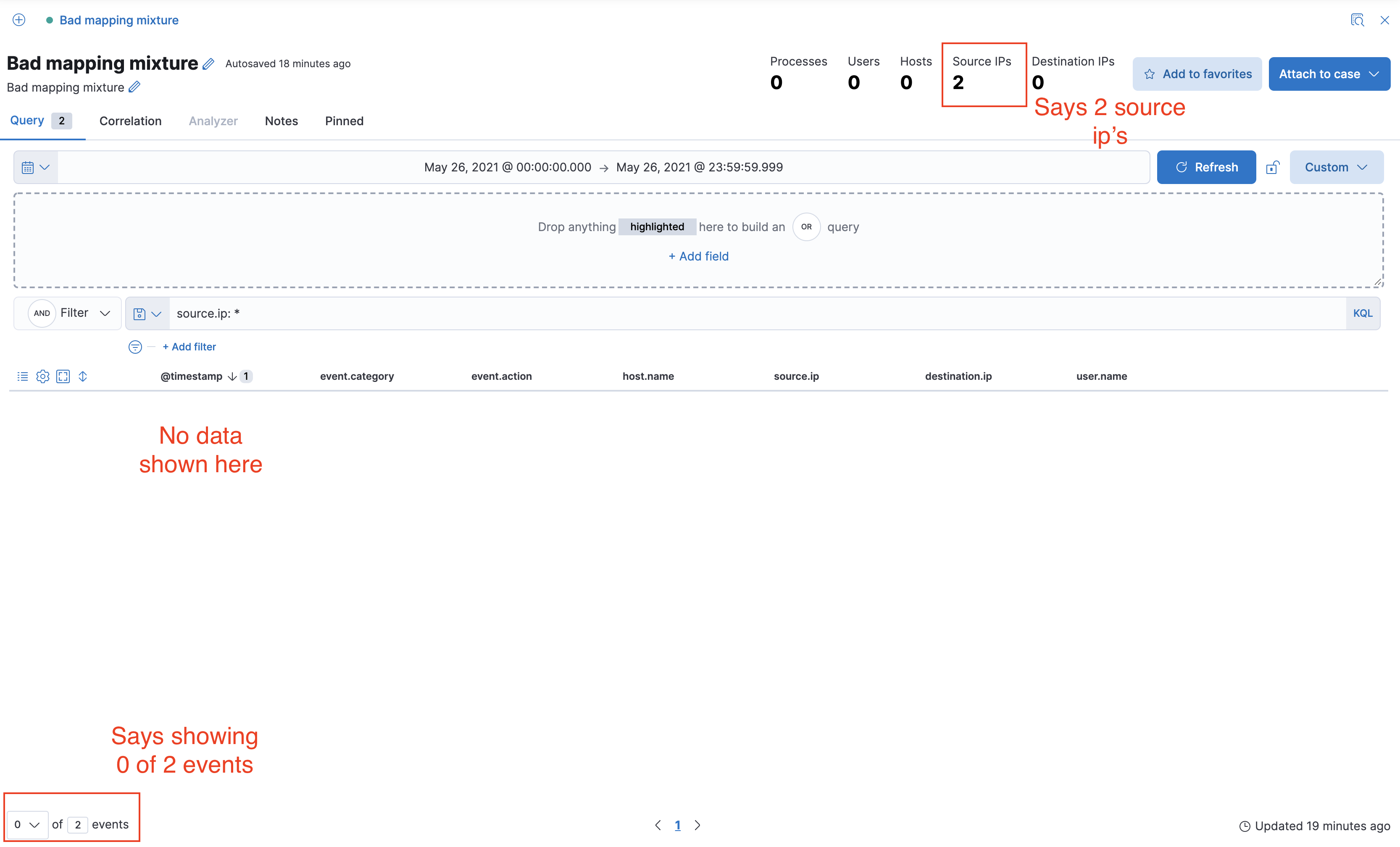

I think I might have figured out what is going on here and reproduced this. If you could, can you tell me what your mappings are for your f5\* message field like so from dev tools:
```auto
GET f5*/_mapping/field/message
Paste the results here and we can see if `message` is a keyword vs a text field. I think the bug is where we have both a `text` field in 1 index and then a `keyword` in another index when using columns for timeline.
If that's true, your workaround would be to re-index any indexes that have `message` into a text field per ECS guidelines.
EDIT: Looking like removing message as a column might not work here if this is the case, so I removed that suggestion.
Here is the Kibana ticket I am getting a peer review on:
> <https://github.com/elastic/kibana/issues/100701>
> \*\*Describe the bug:\*\*
> When we have mixed \`keyword\` and \`text\` fields for a lo…g message, timeline will not show inconsistent data results due to elastic search having partial errors and not returning all of the data set in some instances. Timeline doesn't indicate to the user that a partial error has happened through a toaster error. Timeline UI/UX ends up showing inconsistent data results and different numbers as seen by the screen shots below. However, if the user clicks on the inspect button after they notice that the UI is showing inconsistent data they will see the partial errors.

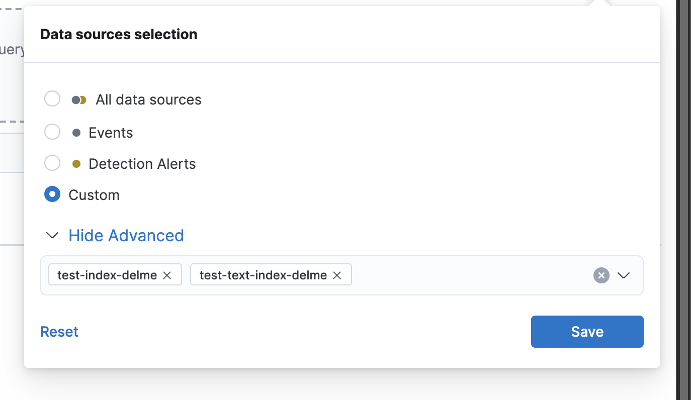

> Create the kibana index patterns for both of those and then use them within Kibana timeline:
> \<img width="687" alt="Screen Shot 2021-05-26 at 10 05 37 AM" src="https://user-images.githubusercontent.com/1151048/119693878-f3406980-be09-11eb-90ed-781df5ce55fa.png"\>
> Query for \`source.ip: \*\` with that given date time range and then you can see that it is showing the following mixture of data and no data:
> \<img width="1666" alt="Screen Shot 2021-05-26 at 10 06 05 AM" src="https://user-images.githubusercontent.com/1151048/119694478-7bbf0a00-be0a-11eb-91d0-c04959c46017.png"\>

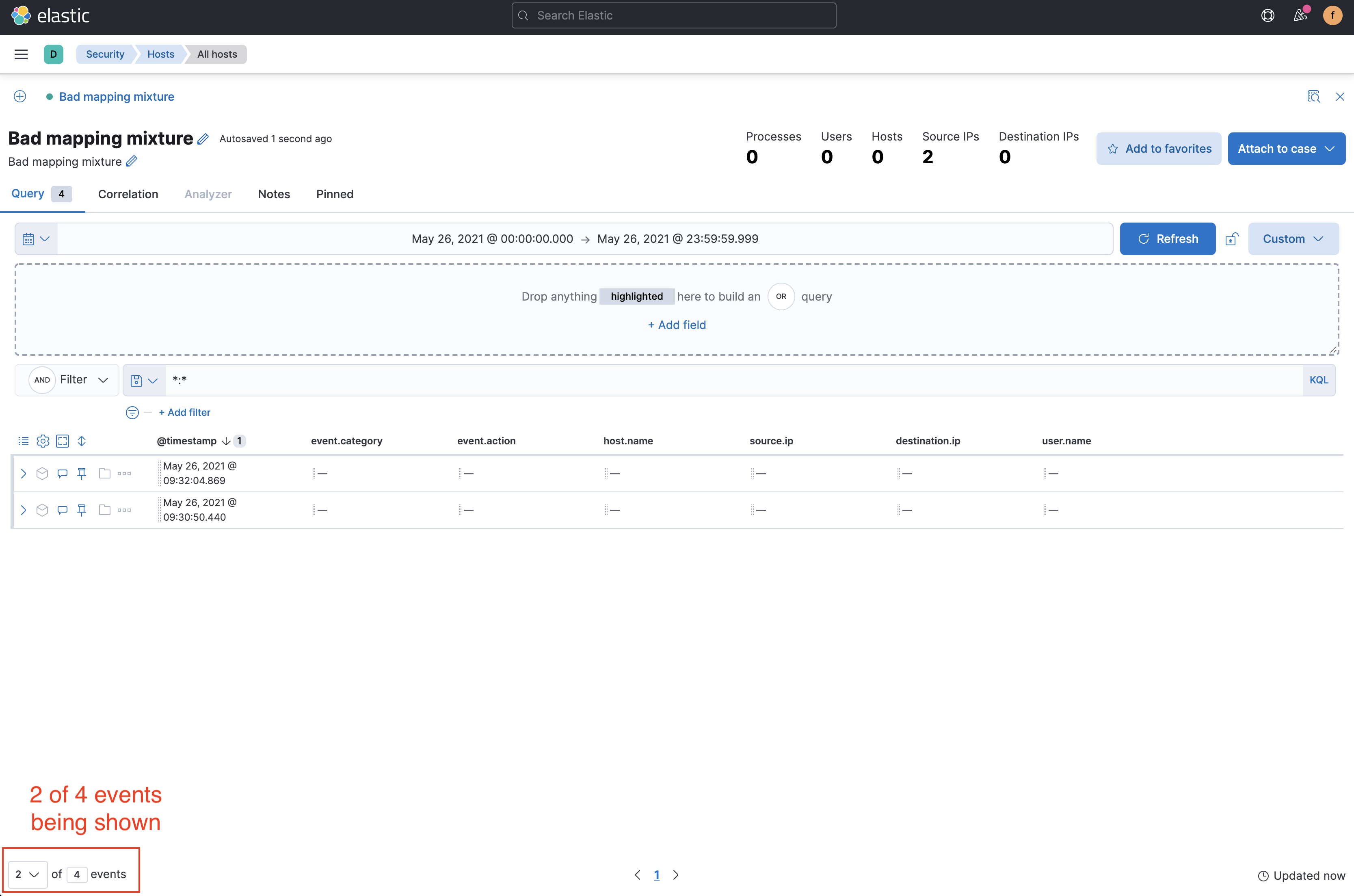

> If you query for \`\*:\*\` it shows only 2 of the 4 rows but says there are 4 records.
> \<img width="1667" alt="Screen Shot 2021-05-26 at 10 10 23 AM" src="https://user-images.githubusercontent.com/1151048/119694786-c93b7700-be0a-11eb-9c82-0244c9add33f.png"\>

> or
> \* Remove the indexes or separate the indexes across Kibana spaces so the keyword ones don't mix with the text field ones.
> \*\*Kibana version:\*\*
> At least 7.12.1 and master
> \*\*Elasticsearch version:\*\*

> [@Frank\_Hassanabad](#):
> `GET f5*/_mapping/field/message`
Thanks for the feedback. This is the mapping for the message field:
```auto
  "f5-logging-000003" : {
    "mappings" : {
      "message" : {
        "full_name" : "message",
        "mapping" : {
          "message" : {
            "type" : "keyword",
            "ignore_above" : 256
So it seems that the mappings are not correct. This is really strange since im using the default mappings and configuration from the latest filebeat client.
I just tried to remove the message collumn but this wont fix the issue. The events are still not shown.

Ok and update from my side. It seems that the F5 index is causing the problems. Its the only index that has keyword as type for the message field.
I just corrected this in the index template. Can i just re-index the F5 indexes now?

Yes, you should re-index and hopefully be ok now.
