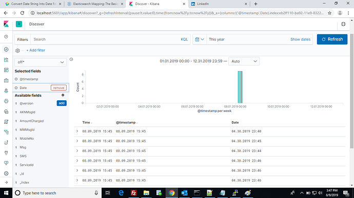

789 create the date format 789 is the index i created on run time can we do this that we create index and then load the data with the same index can the data parse into the same index ??
What should i do then to convert the date format string into data type data you have my config file in the above post and now you have 1 record for testing can you check on your elastic and share the output for me. Really appreciate it !!

At least for the date parse failure, the format in your screenshot is: M/dd/yyyy HH:mm
So:
date {
  match => ["Date", "M/dd/yyyy HH:mm"]
  target => "Date"
See: https://www.elastic.co/guide/en/logstash/current/plugins-filters-date.html#plugins-filters-date-match

the last screenshot i uploaded i use this date format
date {
match => [ "Date", "ISO8601", "YYYY-MM-dd HH:mm:ss", "YYYY-MM-dd HH:mm:ss.ZZZ" ]
target => "Date"
locale => "en"
ok i will try this format also
Thank a tons it woks date is converted in date format !! :slight_smile:
