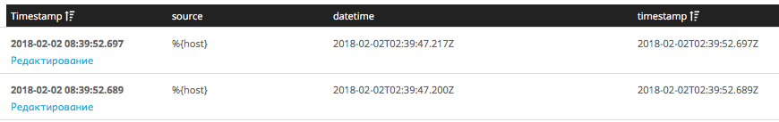

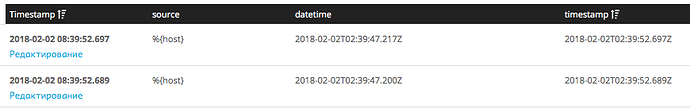

Ok, but last question, may be it is beacause of i use jdbc plugin input?
Hello, i found how to do it)
It turns out logstash does not understand that datetime it is date value.
Need before convert this field to string -
filter {
mutate {
add_field => { "message" => "%{typenameru}" }
convert => [ "datetime", "string" ]
date {
timezone => "Etc/GMT-6"
match => ["datetime" , "ISO8601", "yyyy-MM-dd HH:mm:ss.SSS"]
target => "@timestamp"
remove_field => [ "datetime", "timestamp" ]
