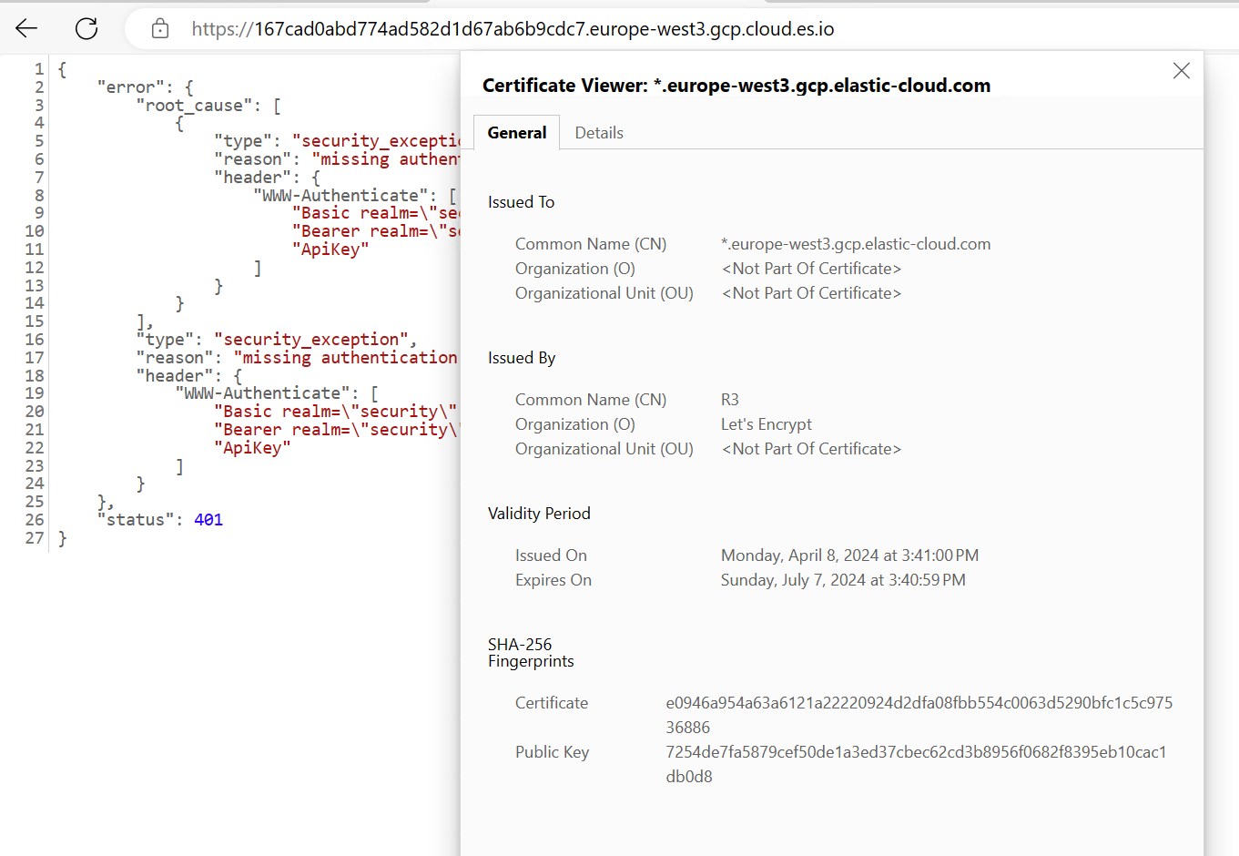

I think I may find where the issue is ? I found there are no lock in my localhost:9200 , and it is complaining cert is not safe . but I have installed the http_ca.crt as root trust cert . and also , when I go in kibana , browser also says , there are no cert in the website .
I found the finger print there

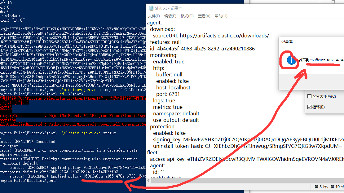

Here is the status
Moreover , I can not see the policy in the output of inspect cmd , it there the problem located ?
Is there any idea about it ?

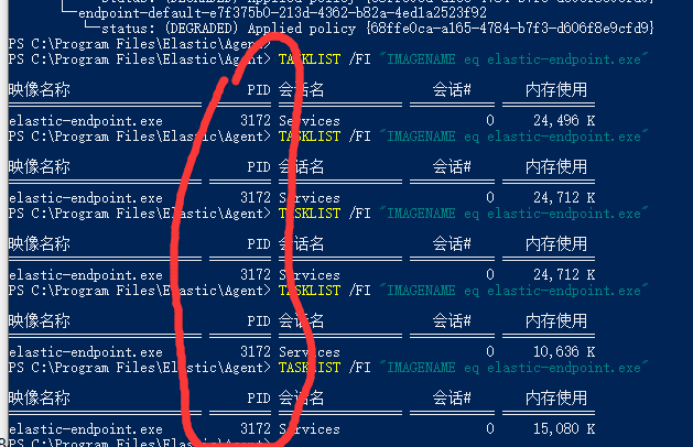

Could you launch Task Manager and check if elastic-endpoint.exe pid is changing? Alternatively you can repeatedly run this in console
TASKLIST /FI "IMAGENAME eq elastic-endpoint.exe"
If it's changing, that's not good, you need to upgrade to 8.13.3.
Also, if you are affected by this bug, but 8.13.3 doesn't solve it, please let us know.
Seems not happening to me ,

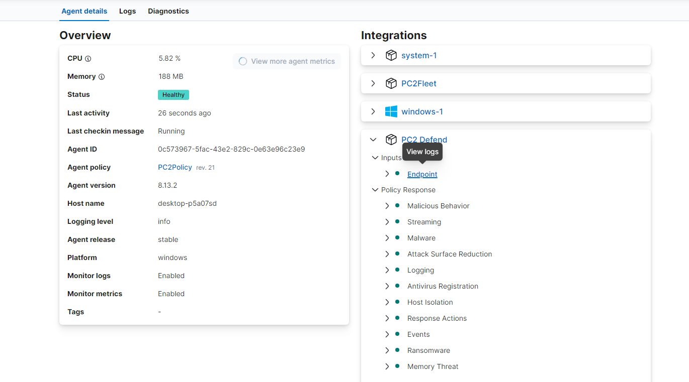

The endpoint is healthy now , I think I am getting close ... only , the output seems still in trouble

Seems working

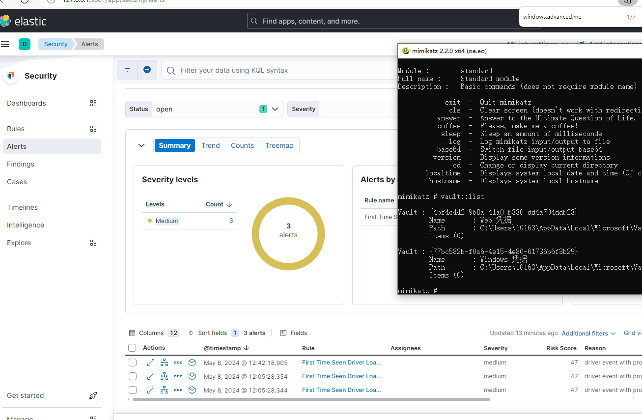

Thank you for all this time , it is now working ! but allow me to ask one more problem , why it can not detect mimikatz , while I have actived 1088 rules?
And then I have set the elastic security from prevent to detect , still no use .. how should I test it ?
You're confusing SIEM rules with Elastic Defend policy. Click the Manage button on bottom-left side, then configure the policy.
Elastic Defend policy defines how Endpoint service is behaving on the target machine. You want everything in prevention mode to have it block malicious things.
SIEM rules run in the stack analyzing incoming data.
I indeed want to anaysis data in the elastic , for that I followed two guides
And I can see they are also adding rules just like mine
Certainly, SIEM has also great potential
