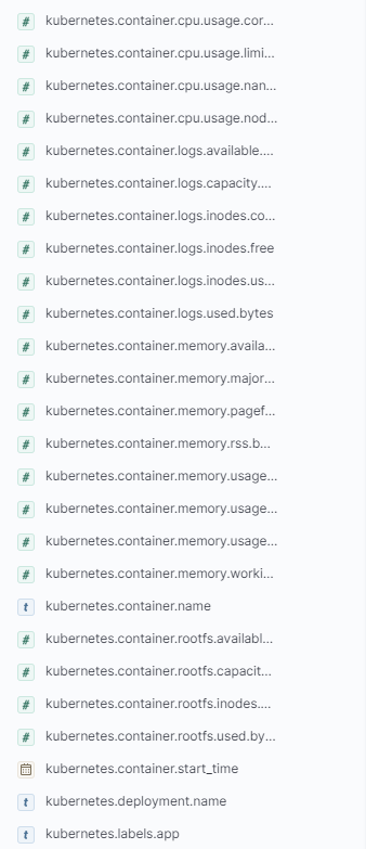

Due to the mapping problem of some fields, I temporarily use the master tag.
about container.id , I can only see it on kibana metric UI, but not on discover.
