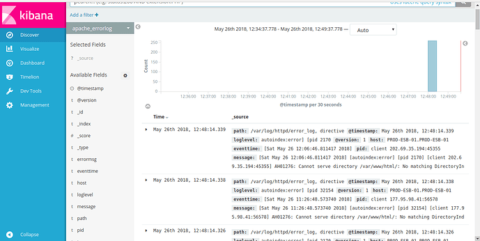

Hey Magnusbaeck,
When I am running conf file from /usr/share/logstash/bin directory then there is no permission error and I am running same conf file. I have uploaded kibana output of apache error log file.
Thank you
