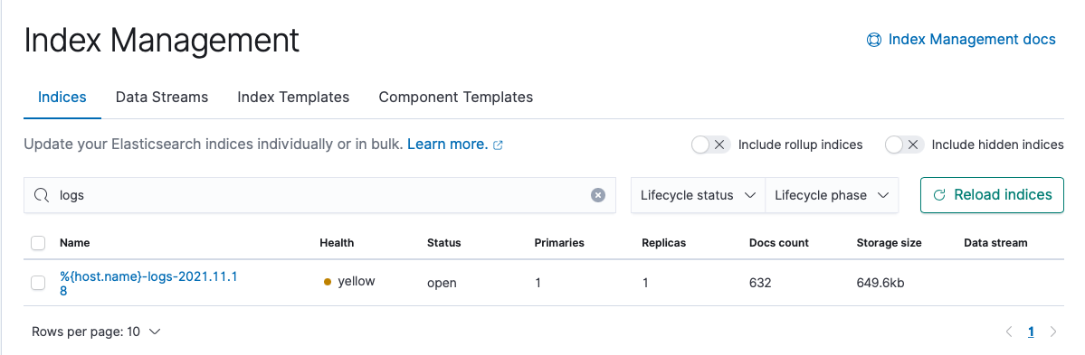

I tried the config you sent. It creates an index directly with the name "%{host.name}-logs-..." :slight_smile:

That refers to a field that has a stop in its name. If [host] is an object that contains a [name] field then this should be index => "%{[host][name]}-logs-%{+yyyy.MM.dd}"
Yep! My bad. @espala Badgers correction should work.
