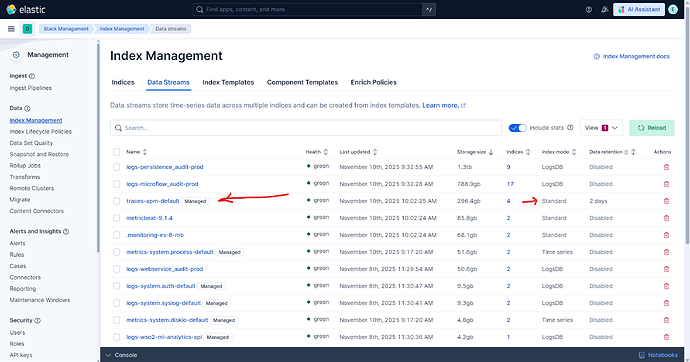

on my server it says otherwise, its not logsdb its just a standard index, not sure what i did wrong

Sorry, maybe I was not clear ... Oh I see. I was not LOL I left out the word NOT :slight_smile:
What you have is exactly correct.
Traces from elastic legacy agents are not logsDB that's exactly what you're showing right there and what I said about apologies if it was confusing.
traces-apm-default are traces from the legacy agents.
