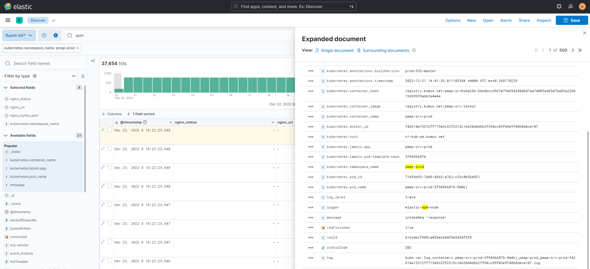

after correcting https to http, i see metrisc cpu & memory, but it`s not transactions, errors...
logs from elastic-apm-node
