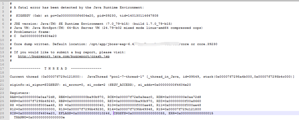

Application is down when run a few mintues
Java Agent Version:1.18.1
JDK Version:1.7.79
APM Server Version:7.4.0
JVM args:
export JAVA_OPTS="$JAVA_OPTS -javaagent:elastic-apm-agent-1.18.1.jar"
export JAVA_OPTS="$JAVA_OPTS -Delastic.apm.service_name=jboss-service"
export JAVA_OPTS="$JAVA_OPTS -Delastic.apm.application_packages=com.*"
export JAVA_OPTS="$JAVA_OPTS -Delastic.apm.server_urls=http://x.x.x.x:8200,http://x.x.x.x:8200"
When run about two mintues every time,the application is down without any log.

There should be some error logs files with name hs_err_pid_xxxx.log in the current working directory or /tmp that could help provide some extra information about the crash.

Could you upload the full log file instead of screenshots of it ? If there are sensitive values in it you could also send it to me as a private message.

I have tried put it in githup:
https://github.com/koala775/hs_err_pid39230
It seems that you have two copies of the agent in your JVM arguments: -javaagent:/opt/app/elk_6/elastic-ap↪m-agent-1.18.1.jar -javaagent:/opt/app/elk_6/apm-agent-java-custom-1.2.jar
One seems to be the 1.18.1 release, while the other appears to be a custom fork.
If you use your own build, you should ensure that it's based on either master or 1.18.1 release and only include one copy of the agent in JVM arguments.
