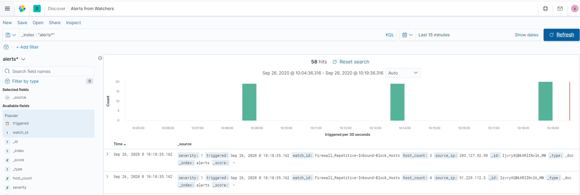

Here is the use case -
When I run the same query in Discover Kibana, I get the events, but the Detection rule is not letting me do it.

here is the discover query-
With the same parameters, here is the Detection rule -
Still no detections.
