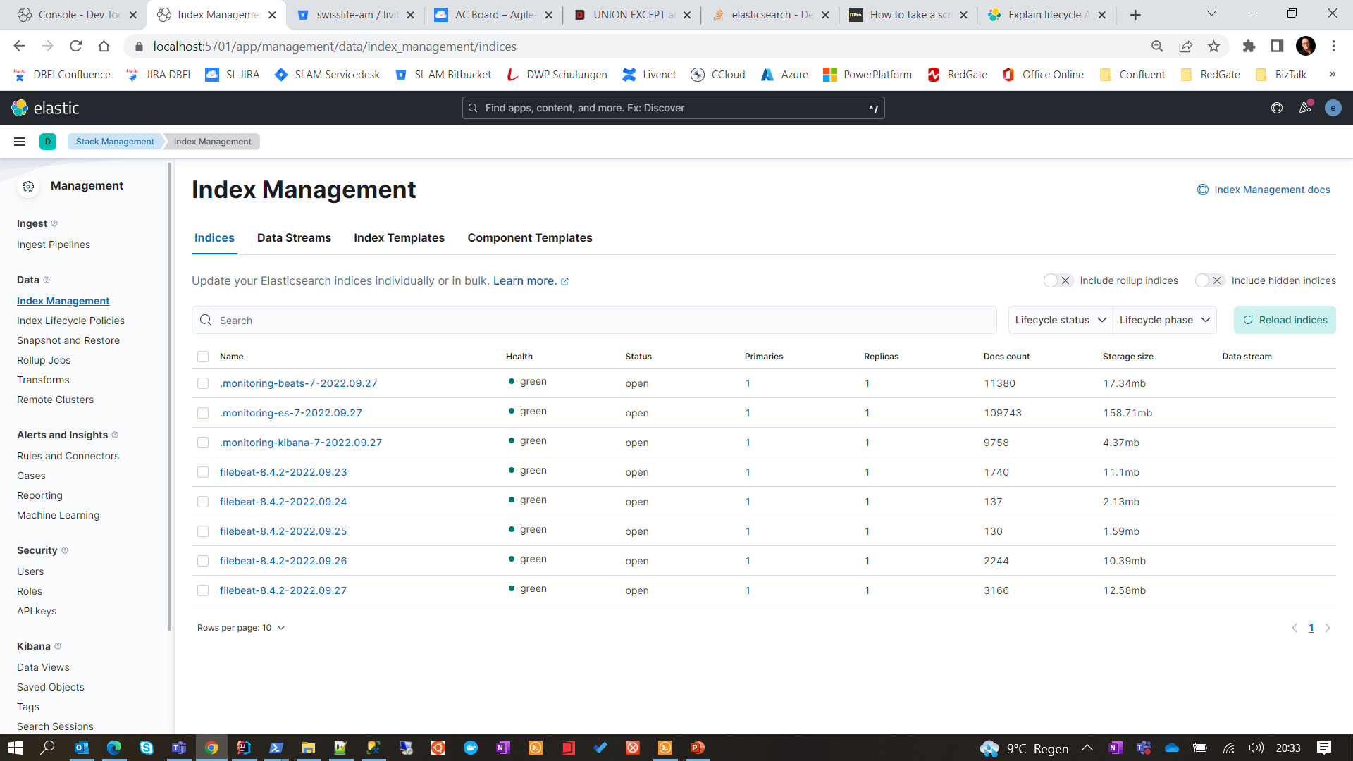

But when I check the indices I have it seems not to delete:
I would greatly appreciate any help to understand what I do wrong or misunderstand...

Hi @thomas_huesler,
thanks for providing such detailed information. Your setup looks fine to me at first glance with one exception: Overriding the output index name like you do in
output.elasticsearch:
  indices:
    - index: "filebeat-%{[agent.version]}-%{+yyyy.MM.dd}"
would interfere with the ILM mechanism, which relies on managing the read/write indices behind an alias. Could you try removing the indices override from your filebeat config?
Dear weltenwort
Thank you very much for your help. I changed the configuration (removing the indices element) as you suggested and tested and monitored the behavior now for multiple days.
It works like a charm now.
