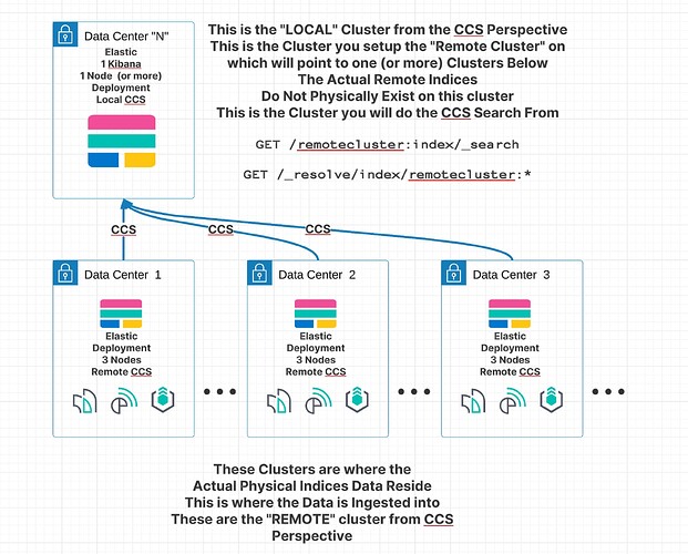

So you got a remote and local to connect on a local subnet is that correct could you do a cross cluster search etc?
From local to remote is connected. But when I try to do a cross cluster search on devtools, I am getting "index not found exception" as shown below .
