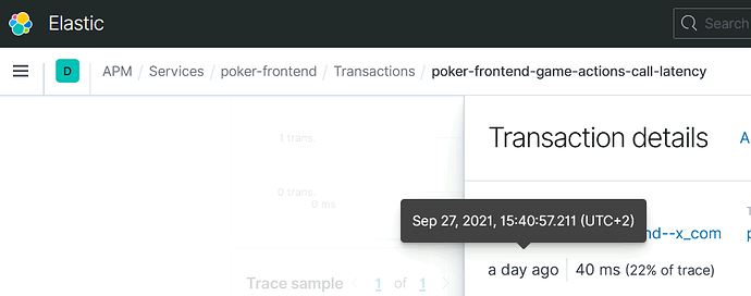

Child transaction starts before parent transaction
We need to measure the latency of the request
The request passes through 2 microservices
The business task is to measure the time of processing on each microservice and also measure the time of network between microservices
We use this article to achieve distributed tracing
As you can see for this picture there are:
  • Main root transaction - poker-frontend-game-actions-call-latency
  • Child transaction - poker-frontend-game-actions-call-latency-games-ws
So we:
  • Create transaction (first microservice)
  • Inject transparent id into headers (first microservice)
  • Send request (first microservice)
  • Get request (second microservice)
  • Get transparent id from headers and create a transaction from parentId
So the problem is that the start time of child transaction is faster than parent transaction (you can see it on pictures below)
Any ideas? how can I debug this?
