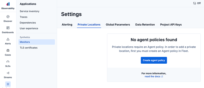

So if your URL is a private one, you need to define a private location:
Did you do that?
nope
Have a look at Monitor resources on private networks | Elastic Docs

I checked that we have configured private location and we named as on-prem. The URLs i have it will be accessible from interanet and there are urls which i can do synthetic montoring and location i am using is on-prem.
What steps you did in this document? Which one does not work?
By reading this document I haven’t created a new private location, in my environment there are 2 private location that i have mention one and other I can’t remember the name .
I think i have to mention to new location but how would i know which location i need ?
Hello @Aniket_Pant
To summarize :
If the URL you are trying to access is Internet facing then we can use any location if it is Intranet URL then we need to use Private location.
About redirect if it redirects from base URL you can change the parameter max_redirects from 0 as per your requirement.
Now back to Private location, this location is created based on Policy which will have Agents. So when you are selecting a location , check the Policy from which the location was created , check the Agents Enrolled in that Policy. You can SSH (login) to this Agent(Host) under this Policy and see if the CURL is working for the URL which you want to monitor via Synthetics.
Another way will be check from where CURL to this URL is working , check this host is enrolled under which Policy and you can used Location related to this Policy for monitoring the URL.
