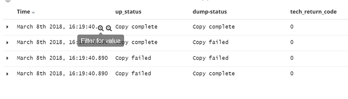

i have two fileds in a csv file dump_status and upload_status then i added a third field called return_code. the values of upload_status and dump_status are copy complete and
copy failed. what i need to is the assign 1 to return code when the two fields have copy complete as value and 0 to other conditions. here's my filter:

it didn't worked when i am testing it with the 4 cases any help please

What does an example event look like? Use a stdout { codec => rubydebug } output to dump the raw event.
i cannot run logstash in debug mode there is a problem in java path although i tried to export JAVA_HOME to its right path but it didn't work although i tried
output {stdout { codec => rubydebug }} it didn't work. is my filter syntax correct?
i am using logstash version 2.3.
