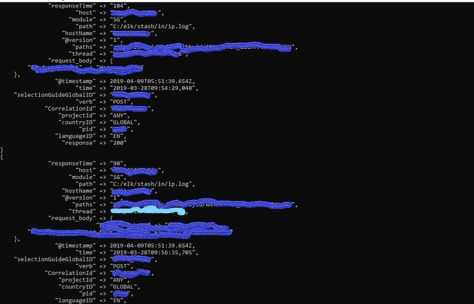

You have not shown us what an event looks like, so we cannot say what is wrong with the aggregate filter. Either show us the filter {} section, or show us an event with output { stdout { codec => rubydebug } }
Check the request_body part, for one log I am getting
request_body{
"A"="X"
for another log I am getting
request_body{
"A"="X",
"B"="Y",
So, basically I want the final one(2nd one),as it contains the element of the previous log also.
