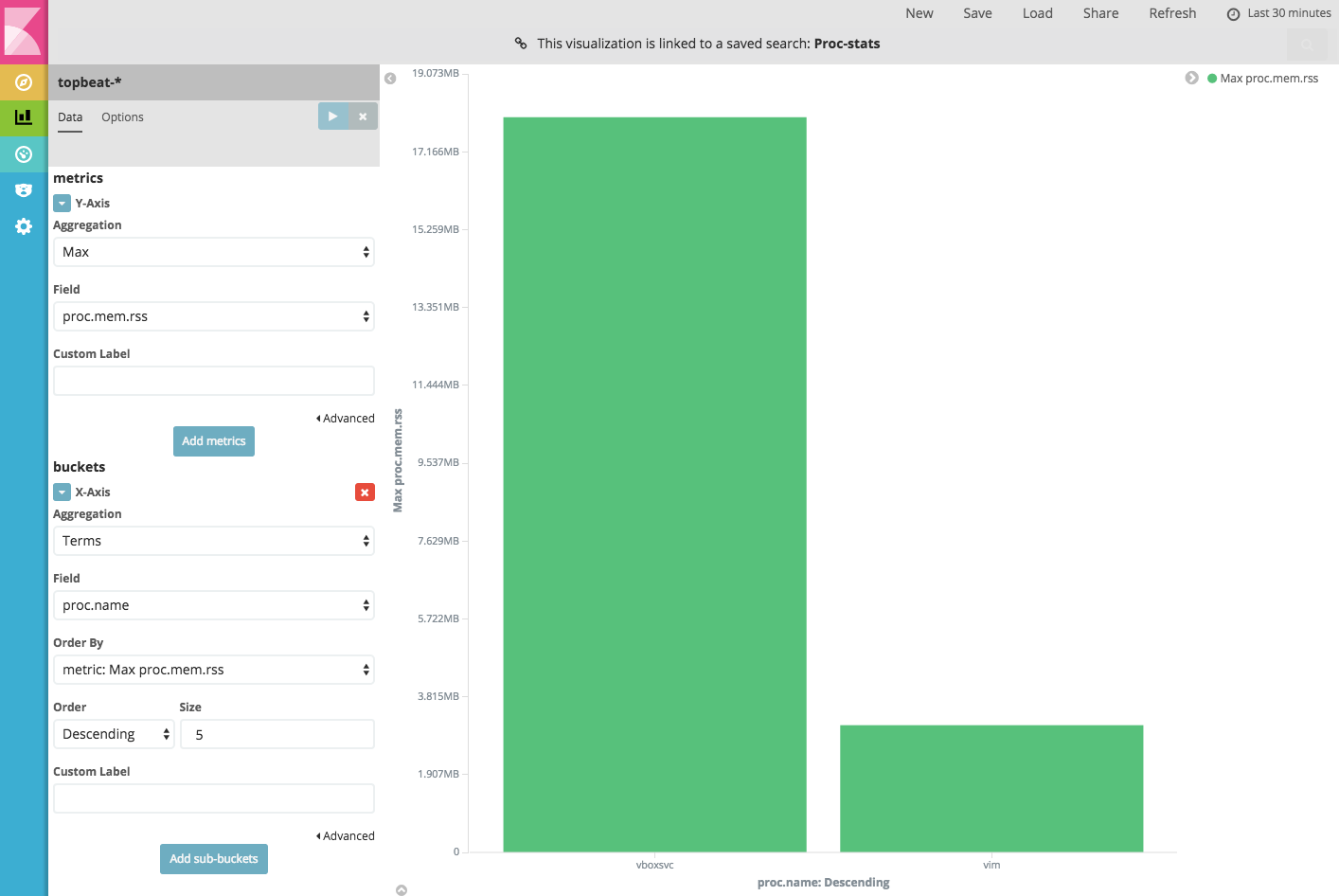

Also, I wanted to set a visualization for these 3 processes (x-axis -> devenv.exe, outlook.exe and explorer.exe) and y-axis(memory).
I can't see what the rest of that memory column says but I think that data would map to the proc.mem.rss field which will be reported in bytes.
In Kibana, the proc.mem.rss field can be marked as Bytes and will be formatted appropriately.
For the visualization, you could use a vertical bar chart.
