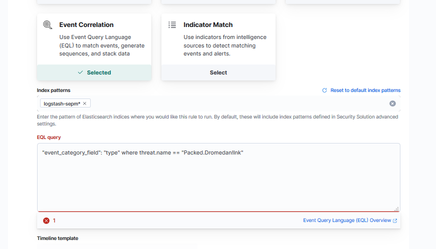

I have Symantec antimalware logs on index pattern logstash-sepm*. In json document I don't have event.category field but I want to create a correlation rule what if the same malware detects on multiple hosts. So I have to first select a value present in event.category like "process" or anything else. I want to declear field "type" as my event.catoegory but it deoesnot work.
Can anyone please explain me how can I define custom event.category here ^

As far as I could understand from the documentation is, we can define custom field like "event_category_field": "file.type" as an event.category if and only if we don't have event.category in the json document.
Here I want to ask how can I define event_category_field through kibana UI. I know kibana UI objective is to run the EQL syntax only but if I am wanting to declear my custom field as event.category how will it be accomplished.
Thank you
Simply you can't from the UI
ok thank you for your reply
