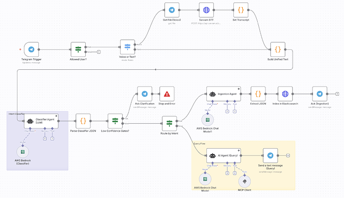

This project turns those natural messages, even voice notes, into structured data and searchable insights using:
  • Telegram as your chat UI
  • n8n as the workflow orchestrator
  • AWS Bedrock (Claude 3.5 Sonnet) used in this demo for intent classification, ingestion, and conversational query agents (you can replace it with any LLM of your choice)
  • Sarvam Speech-to-Text used for voice transcription (feel free to plug in Whisper, Deepgram, AssemblyAI, or something that is confortable.)
  • Elasticsearch Agent Builder + MCP handles storage, semantic search, and custom ES|QL function-calling tools.

n8n Architecture at a Glance
Flow:
Telegram → n8n (STT → Classifier → Ingest/Query routing) → AWS Bedrock LLMs → Elasticsearch (index + semantic search using MCP) → Elastic Agent Builder tools → Telegram response
Key Nodes/Components
n8n Workflow
  • Telegram Trigger
  • Voice/Text switch
  • STT request
  • Classifier agent
  • Ingestion agent
  • Query agent via Agent Builder MCP
  • Elasticsearch indexer
  • Low-confidence gates
Elasticsearch
  • Enabling semantic_text field with Bedrock embeddings
  • Clean index mapping (amount, merchant, category, ts/@timestamp, raw_transcript.)
  • Agent Builder tools built with ES|QL
AWS Bedrock
  • Claude 3.5 Sonnet v2 for:
  • Intent classification
  • Expense JSON extraction
  • Query agent reasoning (function calling via MCP)
