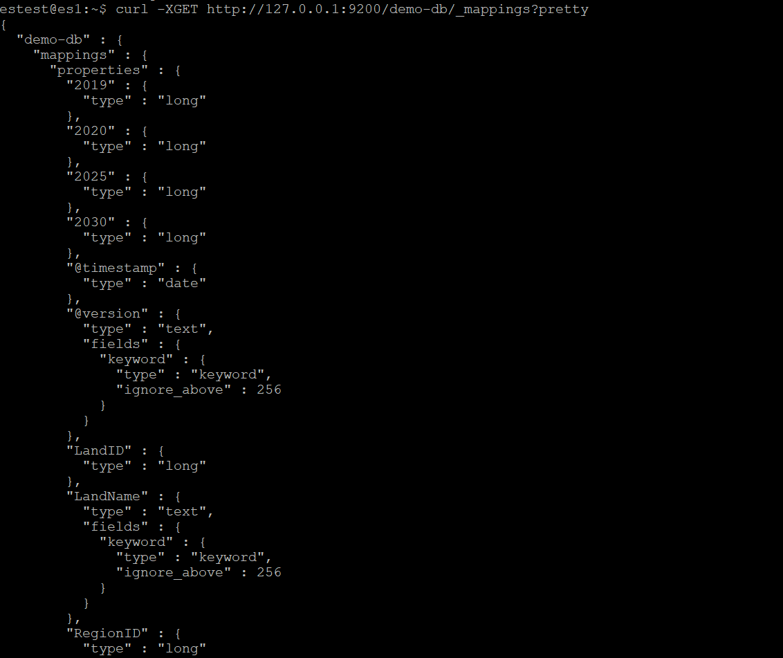

Basically, the goal is to load up Excel data into Elasticsearch. Most commonly the person that created the Excel table is structuring the data in this form or when loading such data from "worldbank.io" the structure is similar.
Uploading this via Logstash and with no filters, because I'm not yet familiar how to use them for good, is not really useful for me, especially when I want to visualize with split series in Kibana. This is the .conf file:
The solution I found is to structure the Excel data in the following form:
This yielded the wanted result and when uploading with the default settings and the mapping seemed fine. I used this .conf file (the column "Einwohner" means "resident" to clear up the discrepancy between the tables and .conf file):
Since I don't want to re-format each Excel table by hand, the question is: How am I able to set up my filter in the .conf file, that the data gets automatically structured in this way?

PS: below the resulting mappings and please let me know if more information is needed:
