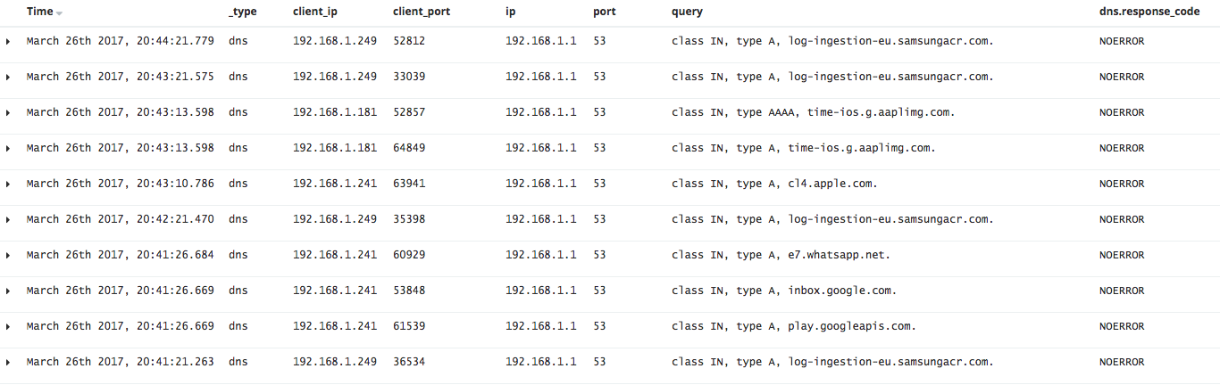

You can see below the relationship between client IPs and source ports and DNS service port as captured by Packetbeat. This exactly what you should expect.
