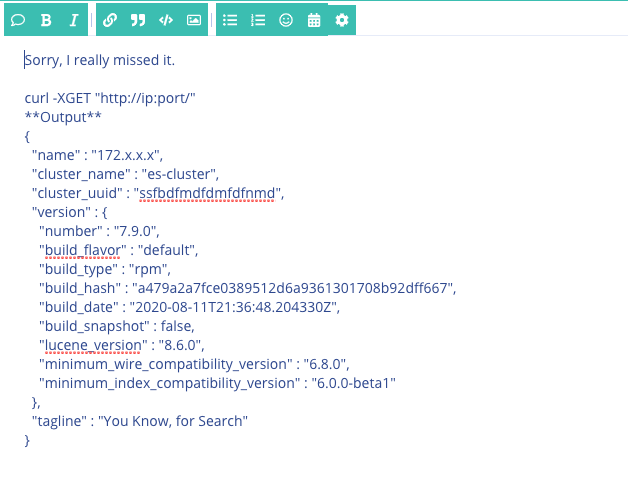

Sorry, I really missed it.
curl -XGET "http://ip:port/"
Output
  "name" : "172.x.x.x",
  "cluster_name" : "es-cluster",
  "cluster_uuid" : "ssfbdfmdfdmfdfnmd",
  "version" : {
    "number" : "7.9.0",
    "build_flavor" : "default",
    "build_type" : "rpm",
    "build_hash" : "a479a2a7fce0389512d6a9361301708b92dff667",
    "build_date" : "2020-08-11T21:36:48.204330Z",
    "build_snapshot" : false,
    "lucene_version" : "8.6.0",
    "minimum_wire_compatibility_version" : "6.8.0",
    "minimum_index_compatibility_version" : "6.0.0-beta1"
  "tagline" : "You Know, for Search"
I edited your post so you can see the difference.
From
Capture d’écran 2021-03-31 à 17.42.34
To
Capture d’écran 2021-03-31 à 17.42.52
So please next time, do not ident the "normal" text.
Back to your question:
"number" : "7.9.0",
Point In Time API has been introduced in 7.10. So you need to upgrade.

Stop formatting as code the text part. Please format only the code part.
Is there anything you don't understand in this sentence that I need to clarify?
