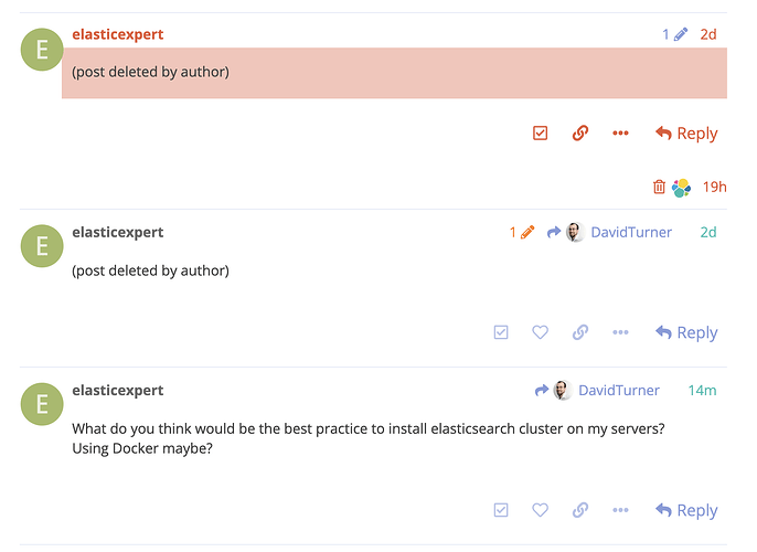

No its not what i meant to do, its just because when i do reply to someone in the first time its not showing this:
Sorry if it looked weird :pray:
EDIT: just to show you (I did a reply on your comment and its not showing):
Ok, that's expected, you only get this indication if you're replying to a post before the last one in the thread. Please stop doing this in any case.
