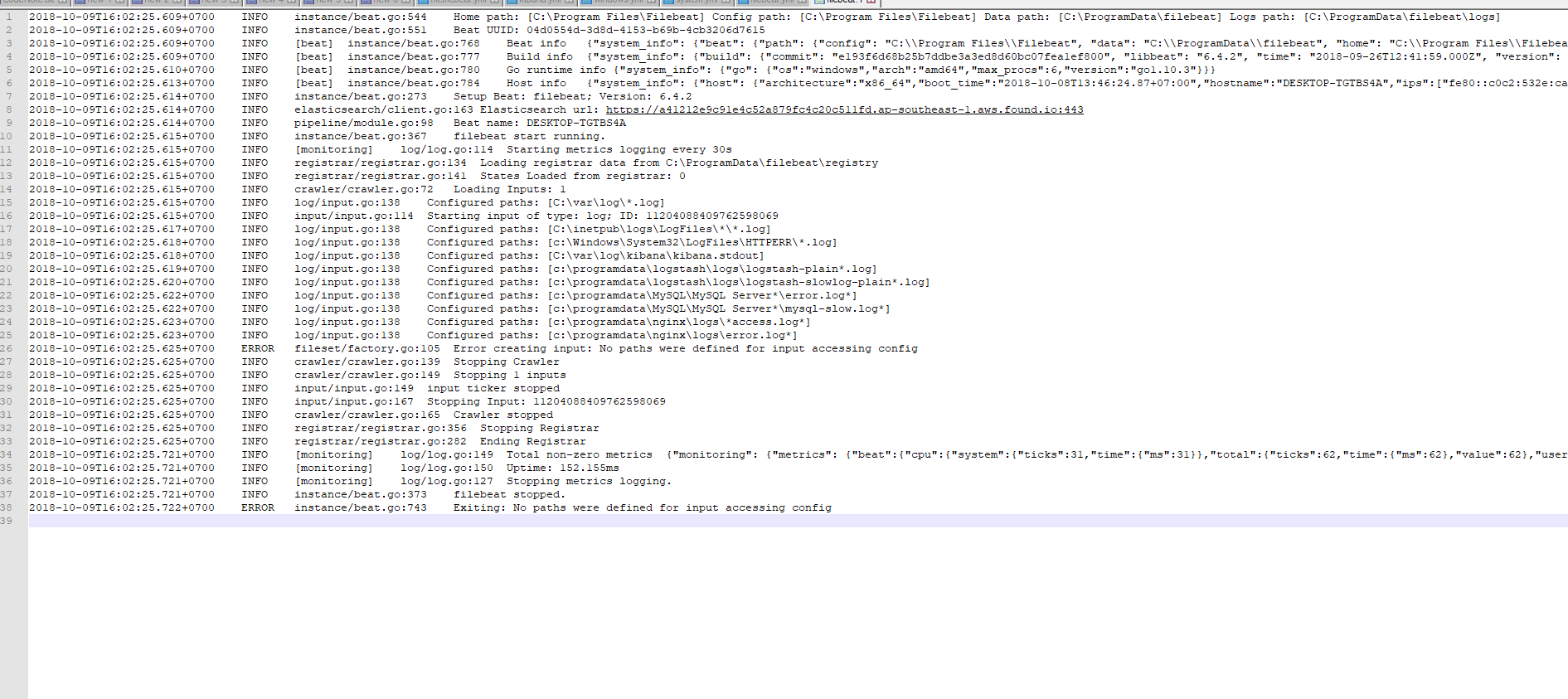

Error creating input: No paths were defined for input accessing config
Hello, I am trial ashosted Elasticsearch Service. And i try to start filebeat, but i have some problem.
I try install filebeat but it come to stopped. Here is my command:
When i open log in C:\ProgramData\filebeat\logs. I received here:
my filebeat.yml file:
(upload://huRHnMcq5G7JqvPrskjpcMS9wxn.png)

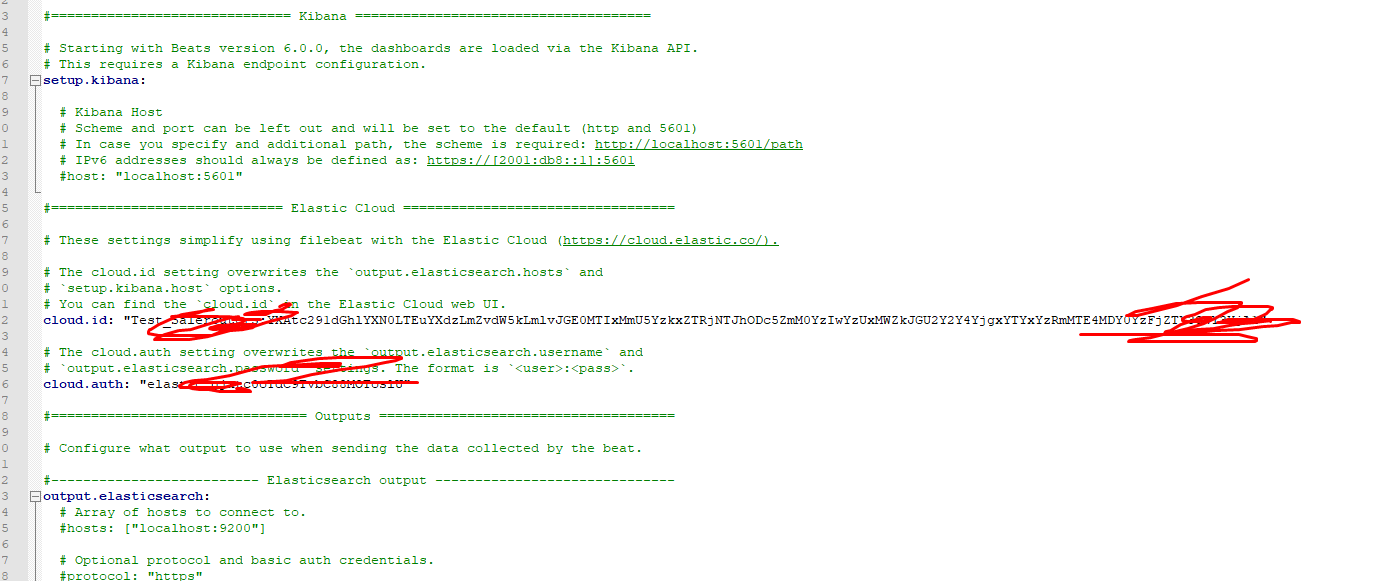

Can you share your complete filebeat config? Please do not share screen shots, but actual text.
Looks like you don't have any module or input configured/enabled.
https://anotepad.com/notes/i84r8m
Here. I can post here. 7000 words limit.
I use hosted Elasticsearch Service. Should I enable any thing in config?

Thanks. Can you take a look in my filebeat config? What should i do?_

I setup sucessfuly some metric in metricbeat. I i did not get lucky in filebeat. Error show on my post. Can you check it?
