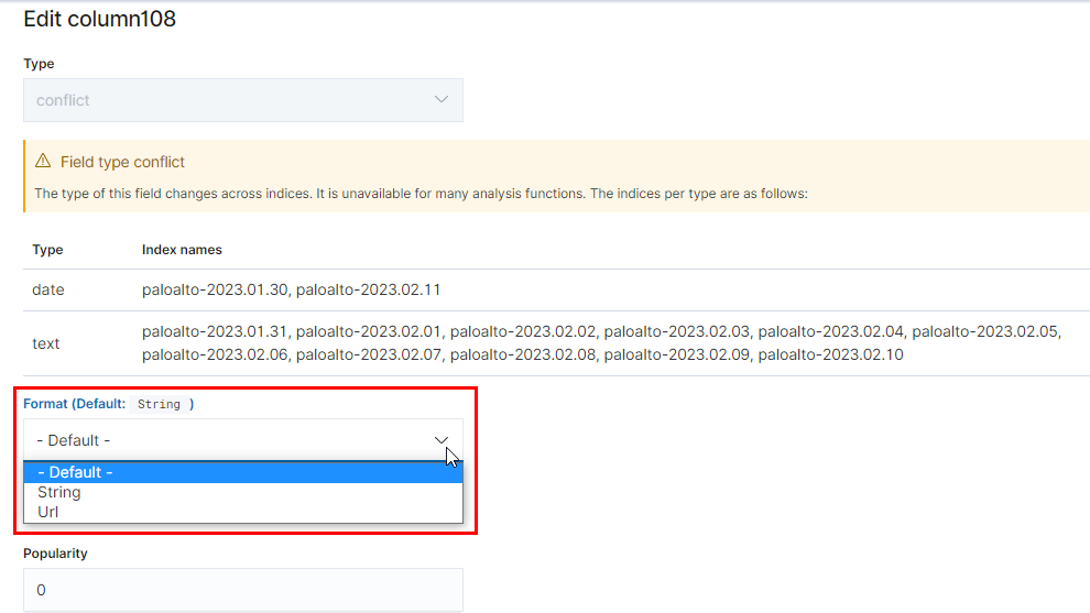

When I enter Kibana from the menu Management > Index patterns > Select the index paloalto, I find the field and it is indeed in conflict.
there is no option to assign it as type "date".

In the current index [column108] is expected to be a date. The string "network-protocol" cannot be parsed as a date.
So some of your events have the wrong data in them. If the first document indexed in a new daily index passes date detection the column will be mapped as a date. If the first document that arrives has "network-protocol" in that column it will be mapped as text.
Once the mapping type is set it cannot be changed. You can use an index template to tell elasticsearch that column should be a date. You will still get the mapping exception (unless you fix your data), but none of your indexes will have the column mapped as text.

@Badger Thank you for taking the time to answer my question, although I must confess with shame that I did not understand anything.
The strangest thing is that the error has disappeared and I have not modified anything.
That says that if "CONFIG" appears anywhere in the syslog message then you are going to parse it as if it is a CONFIG message. But there are other messages that could contain the string "CONFIG" (or "SYSTEM" etc.) somewhere inside them.
You could use if ([message] =~ /,CONFIG,/), but it would be cleaner to parse off the first four fields that (I think) are common to all messages ("FUTURE_USE", "ReceiveTime", "Serial_Number", "Type",) and then determine the rest of the parsing using the [Type] field.
What I think is happening is that one of sections is incorrectly detecting two other types of messages. The csv filter will use column names like column108 of the columns option does not consume all the columns in the event. In one of those incorrectly detected messages column108 is a date, but in a few cases it is a string.
If that is true then fixing the parsing will avoid the mapping errors and you will not have to add a template.
