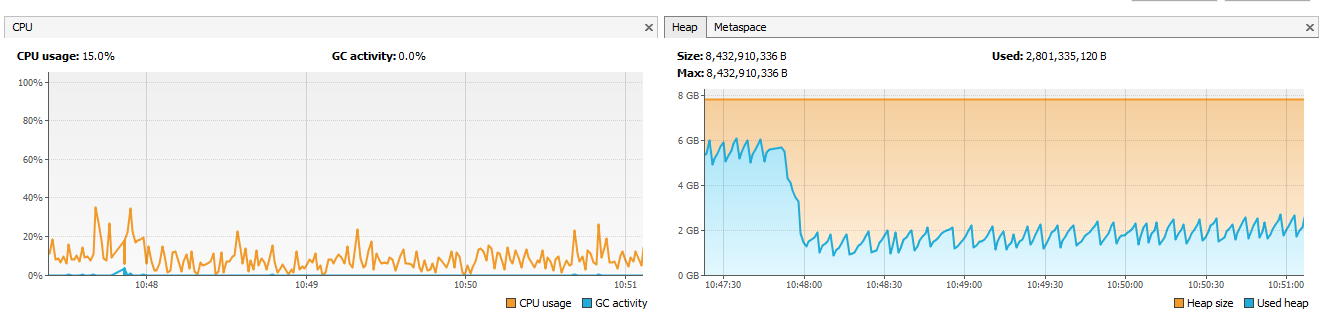

I've checked di JVM stats and they seems to be very good
LS1
LS2
LS3
