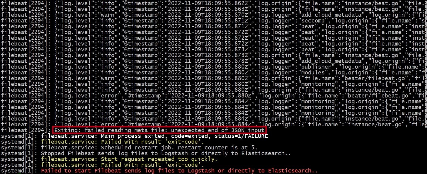

Good afternoon,
OS: Ubuntu 22.04

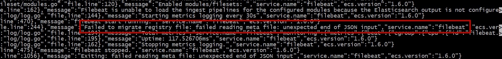

I tried Filebeat (version 8.5 and 7.17.1). Both versions cannot be started with the error:
{"log.level":"error","@timestamp":"2022-11-09T11:28:21.598Z","log.origin":{"file.name":"instance/beat.go","file.line":1056},"message":"Exiting: failed reading meta file: unexpected end of JSON input","service.name":"filebeat","ecs.version":"1.6.0"}
Cannot find any solution on the Internet.
