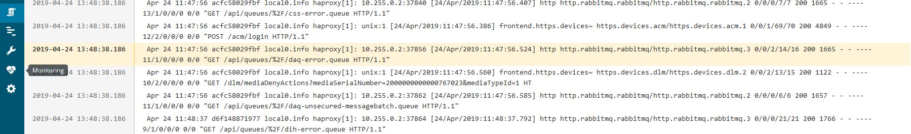

The haproxy logs are sent to elasticsearch because I can see it in the kibana log tab but they are not parser.
see to attachment
I don't have a data display in the default haproxy graphics example (Traffic volume[Metricbeat HAProxy])
