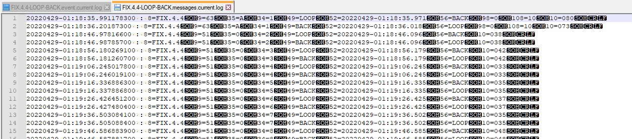

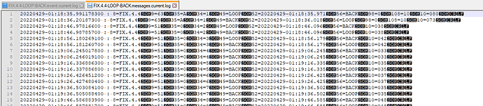

Are your app logs newline Delimited?... Or is it a single line / message in each file without a newline?
If not that could be your issue as Filebeat processes the logs line by line.
This is not the issue, as the files are CR/LF delimited. Anyway, from my cursory look through the Filebeat logs, it seems the events (separate lines) were correctly identified, just not sent to Logstash until it terminated.
