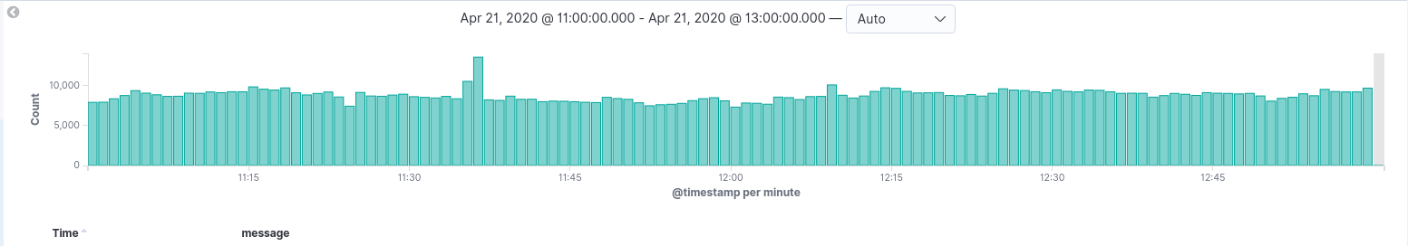

@shaunak - Thank you for the reply. For anyone reading this in the future with a similar situation, I basically identified the last logs written before the gap and the first log written once I resolved the logstash config. I've then went into the log files, done some CLI magic (sed, grep etc) to pull out the missing log lines, write them to a new file then re-ingest those via filebeat.
As you said the "scalpel" approach is much better, if a little more time consuming :slight_smile:
Before:
After:
