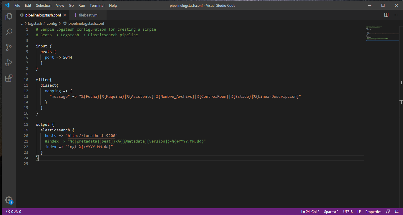

So, to achieve this, I tried a dissect filter in the logstash config file to indicate the pipes as separators and then use Kibana filters to get the information as I need it, but I haven't achieve it.
My configuration file looks like this:
I would appreciate a lot any advice or hint to achieve it

If you want to do it in logstash (rather than by using an elasticsearch query) then you could use an aggregate filter to determine the last message. See example 3.
Make sure you set pipeline.workers to 1 and disable java_execution, otherwise events get processed out of order and last is no longer last.
