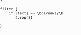

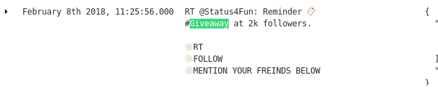

That's what i did, but when i visualized my data with kibana, i still found tweets that contain the keyword 'giveaway'c4
I think my Regular Expression is false
Perhaps \bgiveaway\b would be enough?
I got an error msg
v
Well, you obviously need the surrounding slashes. My example was only the expression itself.
Yes, excuse my mistake.
\bgiveaway\b doesnt work .
