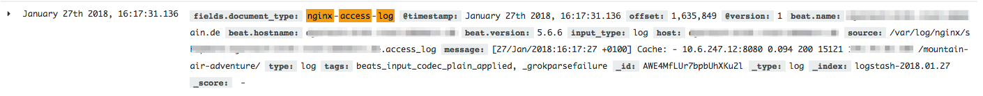

My NGINX access logs don't get aditional tags, moreover I get a _grokparsefailure tag.

Even when I run the NGINX access log filter on it's own, the result stays the same.

You have a match => pattern defined for the apache-access-log type, but not for the nginx-access-log. _grokparsefailure is added when the grok filter is not successful.
Yeah, and since I'm just adding a tag, I've to use mutate and not grok filter:
filter {
  if [fields][document_type] == "nginx-access-log" {
    mutate {
      add_tag => [ "nginx-access-log" , "grokked" ]
This topic can be closed.
