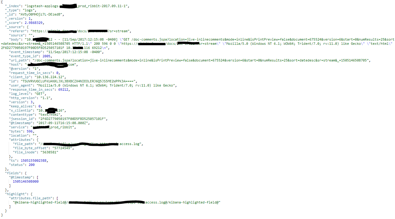

Can you please paste the JSON from one of these entries as you see it in the Discover pane? You say that the logs are being written in EST. They should be written in Zulu notation. I would like to see the expanded JSON. Please include it as text or a screenshot, if necessary.

But it's clear that it's doing exactly what it should be doing. In the top example, I see:
"event_timestamp": "11/Sep/2017:12:15:08 -0400"
And in the same event:
"@timestamp": "2017-09-11T16:15:08.000Z"
This is exactly correct. The date filter has done what it was supposed to be doing. This is event_timestamp accurately re-configured to be in UTC. Clearly, the problem is not in Logstash, or in Elasticsearch. Both are doing exactly what they should be doing, and you've just uploaded the proof.
