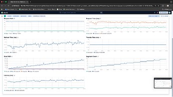

Can you share the index monitoring screens from kibana, equivalent of mine below but for your much more interesting index, with say a typical 1 hour time interval.

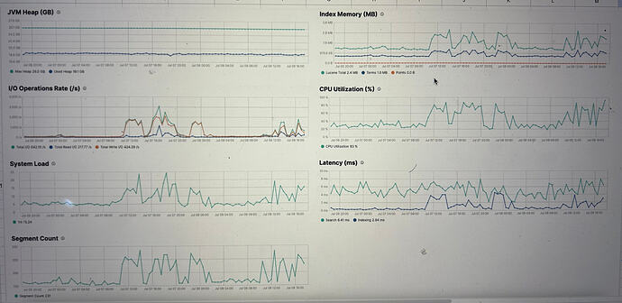

Here are the snapshots during high cpu spikes
Wow, that’s crazy :open_mouth:.

From July? For a period of a few days, rather than the 1 hour I asked (and I implicitly meant current data). Anyways, they show what you wrote to me, there were periods of high CPU for hours. You have changed a lot of things since July. You ran the lsblk command today, why not get the screenshots today? The IOPS are not high at all, not ins same ballpark as the Samsung product spec sheet you shared.

I had those screenshots handy, hence shared those…but those were the final screenshots after all the optimizations (adding dedup layer, reduce writes, add co-ordinate nodes etc) we had done.
I can share some recent graphs in the morning as well, but the data is pretty much the same.
