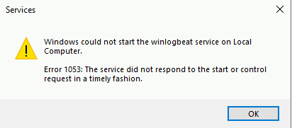

Hello! I have tested it now and it doesn't work. I get an error when start winlogbeat (7.1.1 version)
I try my and yours variants. But it works without "processors" block.

@smerzlyakov Sorry, the script processor was added in 7.2.0 so is not yet available in your version. Can you use a newer version?
In theory yes, but it a little bit difficult. I need to read all migration guides and i think ECS is changed, so i will have troubles with indexes.
Is there another option?If no, i will try to begin update process. By the way, can you give me a link how to prepare for upgrading?
@smerzlyakov In general, we try to maintain backwards compatibility between minor releases. The release notes have very few changes for Winlogbeat between 7.1 and 7.2 so it most likely should not be a problem. But always good to test, you could run them side-by-side for a while and check for any differences in the data e.g. number of documents and some spot checks of some documents.
We actually don't backport bugfixes to older minors of a major (so there most likely won't be a 7.1.2 bugfix release), so I would recommend going to 7.3.2.
The "upgrade guide" for upgrading between minor versions is very simple: upgrade [...] by simply installing the new release and restarting the Beat process. :slight_smile:
