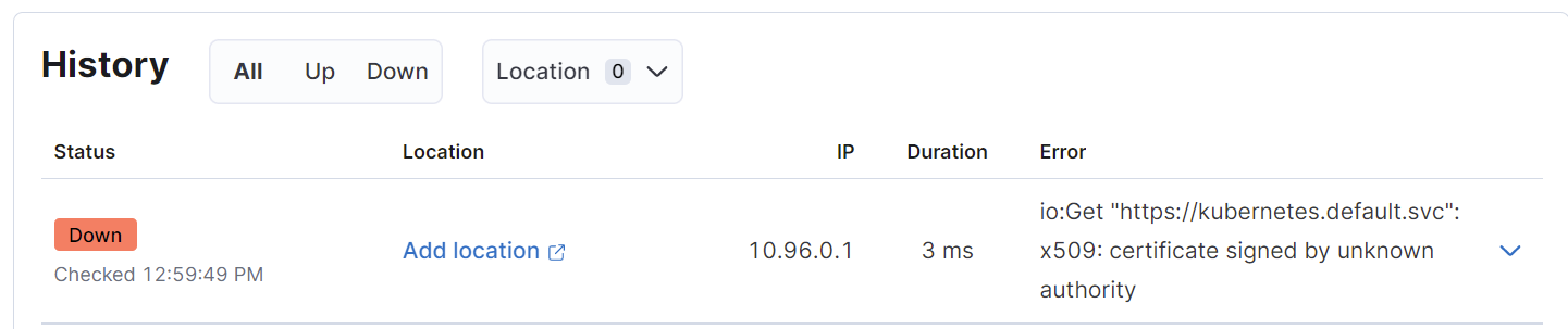

Let me retrace a bit the, what error/s do you receive when setting up heartbeat monitors for these SSL endpoints that you mention?
If you don't specify ssl: options, Heartbeat should try to validate using the system's default cert pool, which should include GoDaddy's CA.
