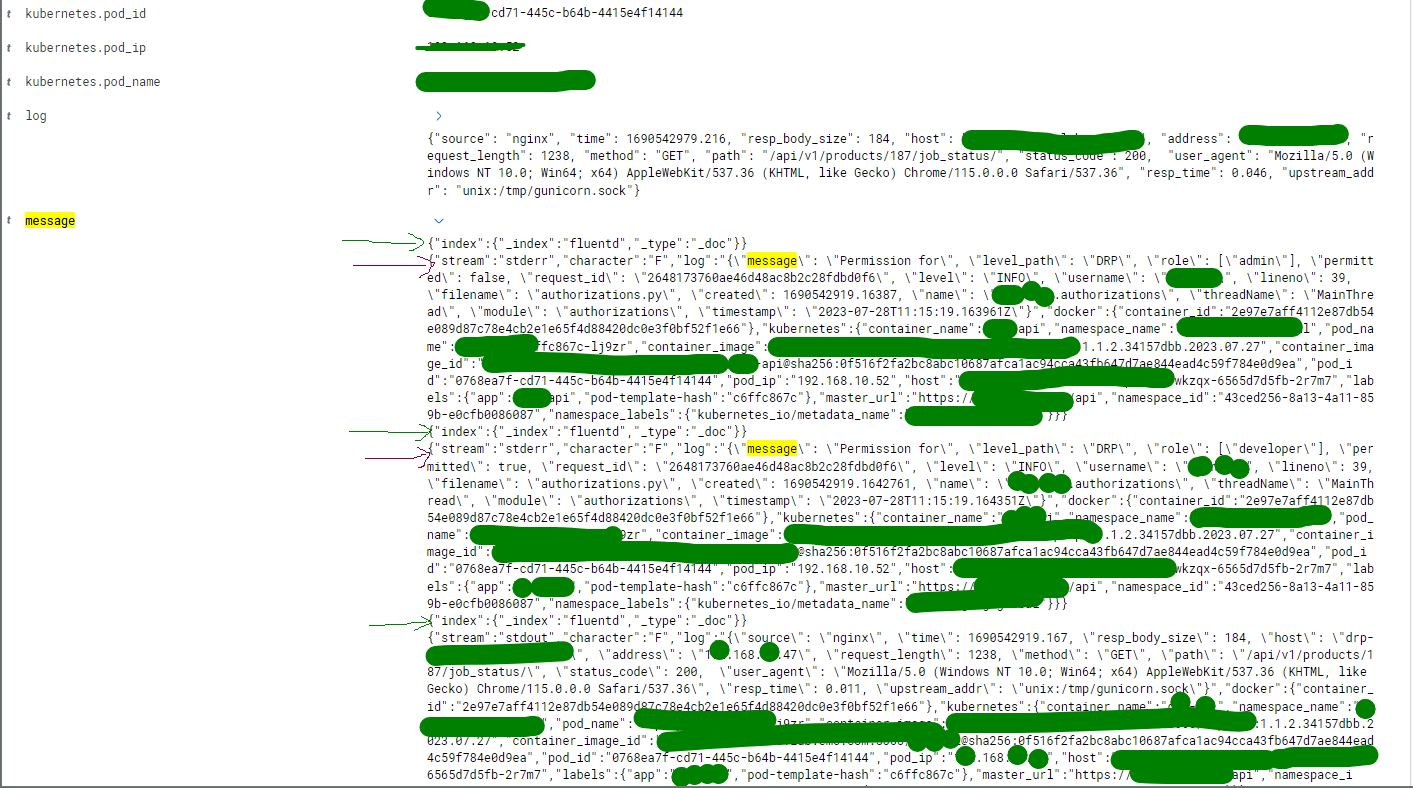

@leandrojmp : Strange behavior is that, log lines starting with "source" appears on the Kibana dashboard, while the log lines starting with "message" are totally missing on the Kibana dashboard.
I'm stumped here, what could be the reason ?
Present (seen on Kibana dashboard)
{"source": "nginx", "time": 1690544622.749, "resp_body_size": 58, "host": "business.org.dev.com", "address": "192.10.3.09", "request_length": 375, "method": "GET", "path": "/api/v1/", "status_code": 401, "user_agent": "check_http/v2.3.3 (nagios-plugins 2.3.3)", "resp_time": 0.003, "upstream_addr": "unix:/tmp/gunicorn.sock"}
Absent(not available on Kibana)
{"message": "Not Found: /api/v1/products/undefined/job_status/", "status_code": 404, "request": "<WSGIRequest: GET '/api/v1/products/undefined/job_status/'>", "request_id": "57de5b467fdc4cb6b4748c0497a271f7", "level": "WARNING", "lineno": 224, "filename": "validate.py", "created": 1690544635.1029072, "name": "django.request", "threadName": "MainThread", "module": "log", "timestamp": "2023-07-28T11:43:55.102995Z"}
{"message": "Exception with 401 response", "exc_info": "Traceback (most recent call last):\n  File \"/usr/local/lib/python3.8/site-packages/rest_framework/views.py\", line 497, in dispatch\n    self.initial(request, *args, **kwargs)\n  File \"/usr/local/lib/python3.8/site-packages/rest_framework/views.py\", line 415, in initial\n    self.check_permissions(request)\n  File \"/usr/local/lib/python3.8/site-packages/rest_framework/views.py\", line 333, in check_permissions\n    self.permission_denied(\n  File \"/usr/local/lib/python3.8/site-packages/rest_framework/views.py\", line 174, in permission_denied\n    raise exceptions.NotAuthenticated()\nrest_framework.exceptions.NotAuthenticated: Authentication credentials were not provided.", "exc_type": "NotAuthenticated", "exc_message": "Authentication credentials were not provided.", "exc_args": [], "exc_filename": "/usr/local/lib/python3.8/site-packages/rest_framework/views.py", "exc_module": "views.py", "exc_lineno": 174, "status_code": 401, "req_method": "GET", "req_path": "/api/v1/", "request_id": "e173fd9dde714660bf09bf1273b57f96", "level": "WARNING", "lineno": 55, "filename": "exceptions.py", "created": 1690544622.748727, "name": "business.core.exceptions", "threadName": "MainThread", "module": "exceptions", "timestamp": "2023-07-28T11:43:42.748939Z"}
{"message": "Role for", "role": ["read", "transfer"], "permitted": true, "request_id": "be64716819a53a89j8765tdbv4sd", "level": "INFO", "username": "roney cole", "lineno": 131, "filename": "validations.py", "created": 1690544615.5304928, "name": "business.core.validations", "threadName": "MainThread", "module": "validations", "timestamp": "2023-07-28T11:43:35.530529Z"}

@leandrojmp - Entire Log lines starting with "message" are missing.
E.g.
filter configuration is
filter {
    json {
       source => "message"
    mutate {
      remove_field => [ "_id", "headers", "_type", "character", "@version", "_index", "_score", "message" ]
If I don't remove the message field, the entire log line or document gets into the "message field" thrice.
I mean , same log lines gets repeated on the message field three times.
@leandrojmp : I have attached couple of screenshots of one of the document/event from the dashboard of one of the service.
I hope that provides more context rather than my explanation :slight_smile:
Well, this is really confusing.
What is the source of your message? This looks way different from the other examples you shared.
The message in your screenshot looks like a request that you would make to elasticsearch, it is not clear why you are sending this to logstash, can you provide more context?
But if the entire log is missing, did you check logstash logs to see if there is any error?

What I mean is that this is the message you shared in your first post.
{"asctime": "2023-07-26 09:05:08,271", "levelname": "INFO", "pathname": "/app/realtime_processor/parallel_processor.py", "lineno": 280, "message": "comment_body: **SonarQube Quality Gate**\n\n[![Quality Gate passed](https://... does not match defined phrase: rerun ingress-garuda-prod", "namespace": "challenger-rover", "version": "jfrog.artifactory:5060/drpbuilds/list-groovy-real:583eb6a", "pod": "ingress-garuda-prod-647c5d755-7jmwx"}
I assumed that this is what was being sent to Logstash.
But the message in your screenshot is completely different, you have a lot of more fields, and you have what would be multiple messages inside this original message field.
So it is not clear what is exactly being sent to Logstash.
It is messages like the first one you shared, or something like the one you shared in your screenshot where you have multiple lines starting with {"index", also you didn't say how are you sending it.
This makes total difference on the troubleshoot, for example if you are using a Contet-Type as application/json while sending to logstash, this would already parse your message.
Can you provide a sample in plain text of what you are exactly sending to logstash?
