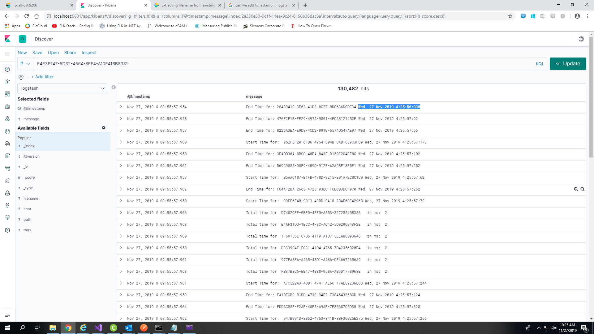

I want Start Time for 10E5F59F-A18D-4840-8E47-7A96F1417398 : As a message
and Wed, 27 Nov 2019 5.58.29.894 as timestamp
Publishing topic For D50CA1C2-CAF4-4822-9AF7-BF28065F15E5 Signal0 with value -0.287098 : Wed, 27 Nov 2019 6.15.44.108
Publishing topic For D50CA1C2-CAF4-4822-9AF7-BF28065F15E5 Signal0 with value -0.287098(Message)
Timestamp- Wed, 27 Nov 2019 6.15.44.108
