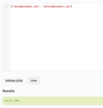

I checked code by the:
is it wrong?
@Badger Thanks a lot you were right!!
When i pass to logs:
{"aaa":"123"}
It breaks
So it should be passed (with spaces):
{"aaa" : "123"}
magic! Need some time to solve it :slight_smile:
