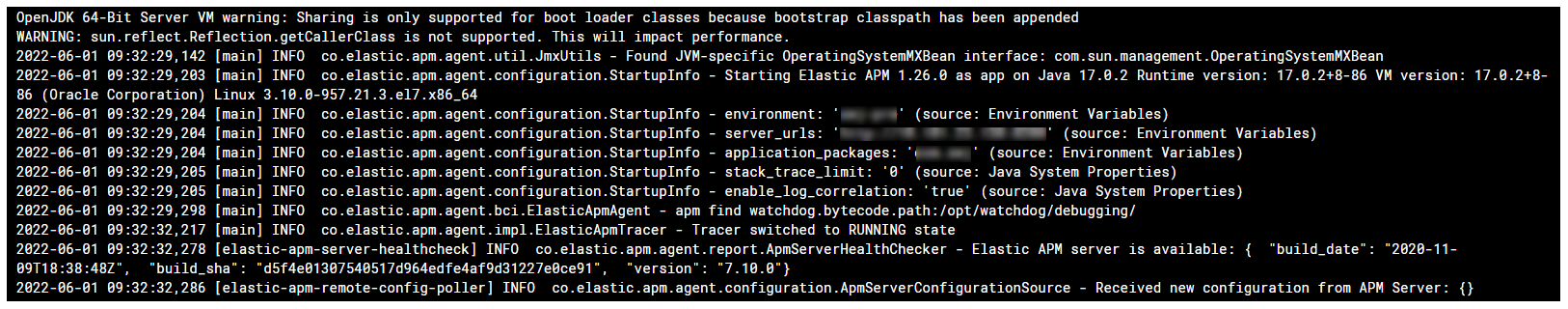

  • agent configuration (should be visible in the first few lines of app or agent logs).

The reason I was asking for your agent configuration is to know if you are using the sampling profiler which could trigger similar crashes (often inirectly by triggering JVM bugs). From your report it does not seem to be enabled but it's better to double check here.

The agent configuration like this:
