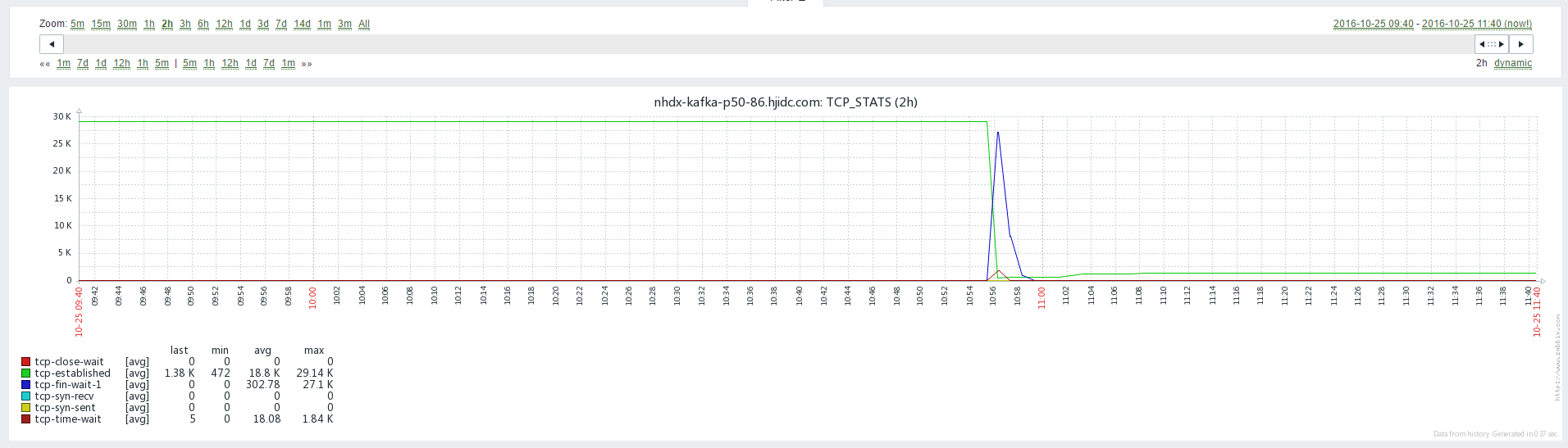

Kafka TCP connection status in last months:
Manually stop Kafka Service:
