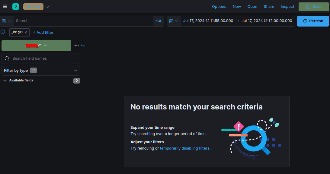

Note that the query you are running on Kibana _id:g12 is not the same query as you are running within dev tools.
Could you share a screen capture of the index pattern configuration?
Also what is your version?
Version is 7.17. Not sure where index pattern configuration is. There is Kibana>Index Patterns which have myindex* in it.
Your test document does not have the @timestamp field set and since your index pattern is created for data having this field present and apply a filter on it (top right corner) this test document will never show up in the results.
Yes. This is the screen capture I wanted to see.
... and I fear we are now on a different issue than the one first reported.

I should have applied timezone shift in my query apparently. So now I can see that the inserted log is immediately searchable.
I still don't know why there is a delay. I guess I have my answer to my original question. There is no delay in searchability. Though I did my test in a test environment. May also do it in production.
