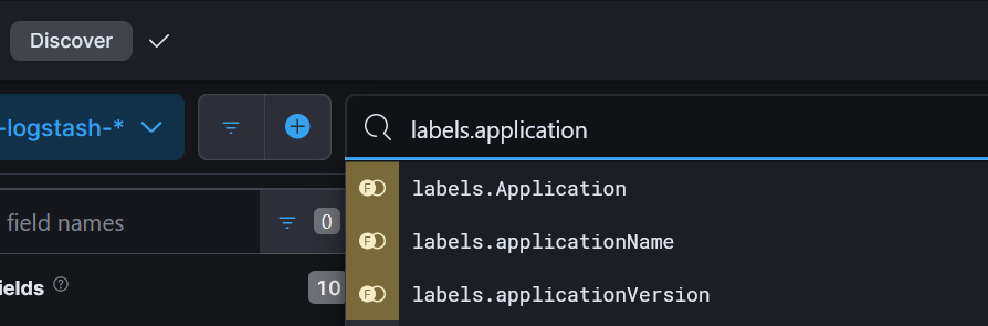

So when you type this into the KQL Bar and wait do you see autocomplete values show up
lables.applicationName: <--- SORRY FIXED
Like this

Apologies in the first example I had a typo
1st example Put this in and wait...
2nd Picture field names are case sensitive so pick one then the : choice should appear select that and wait... you should see autocomplete
3rd You can also filter for a keyword on the left Field Selector and click on it and it will show you the available values
basically use type ahead and select.
