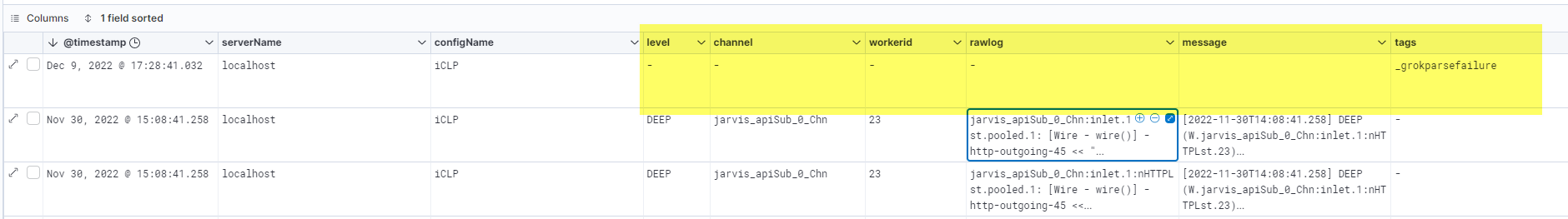

which naturally is causing Kibana to report an empty line:
enter image description here
