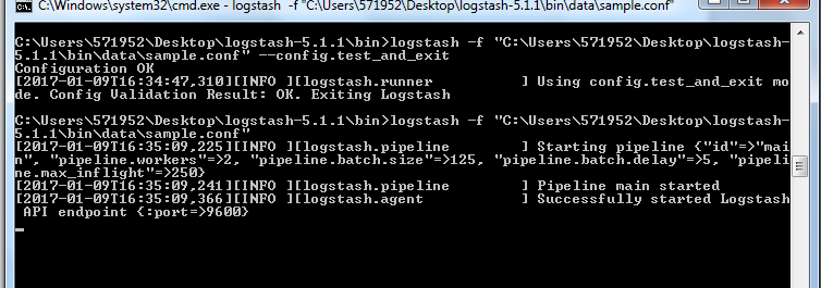

Thanks,that change which you had mentioned is worked fine. But i cant able to see just_queries in my output folder.It seems my logstash is started successfully but nothing happened ..
